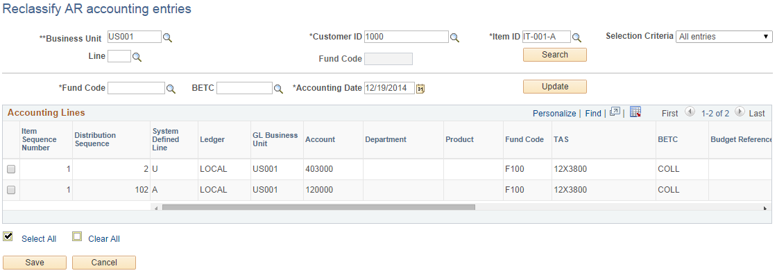

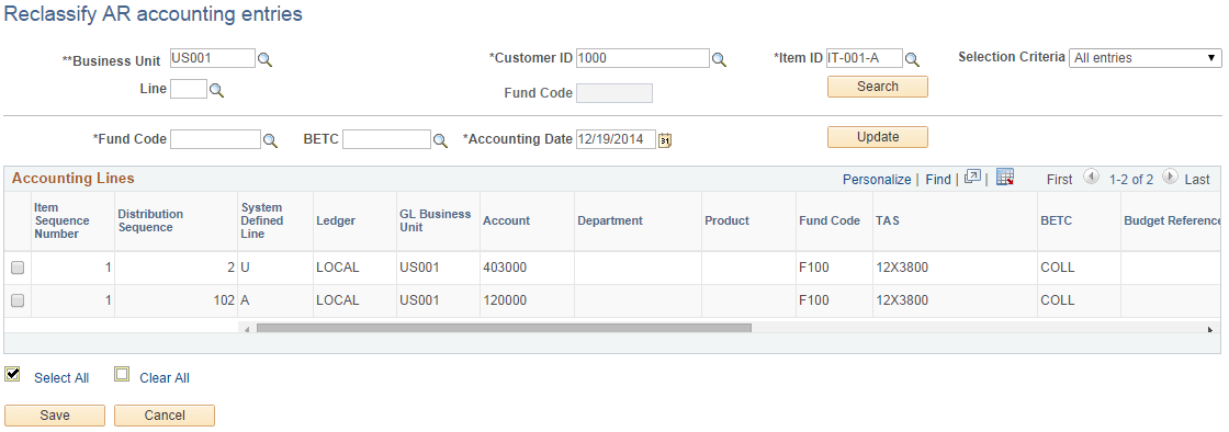

 PAR224_ARENTRIES  |
 Change the fund associated with posted accounting entries. You can reclassify the entire stream of the transaction. The reclassification entries are recorded in the PS_ITEM_DST table with a sequence number starting from 600. You can also change the BETC and accounting date.  |

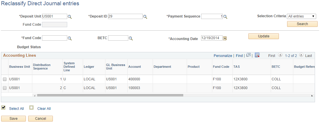

 PAR224_DIRJRNL  |
 Identify accounting entries for direct journals and reclassify the entries to correct the fund. The reclassification entries are recorded in the PS_PAY_MISC_DST table with a line number starting from 600. You can also change the BETC and accounting date.  |

Use the Reclassify AR accounting entries page (PAR224_ARENTRIES) to change the fund associated with posted accounting entries.
Navigation:
This example illustrates the fields and controls on the Reclassify AR accounting entries page. You can find definitions for the fields and controls later on this page.
Field or Control  |
Description  |
Item Search  |
 Click to display the accounting lines that match the entered business unit, item ID, customer ID, fund code, and accounting date.  |
Selection Criteria  |
 Select the types of entries to display in the Accounting Lines area. the values are All Entries and Reclassification Entries.  |
Update  |
 Click this button to generate new accounting entries for the selected accounting lines after you have entered the appropriate fund code, BETC, and accounting date. The system generates reversal entries for the selected accounting lines and creates new accounting entries with the following attributes:
Use the Reclassify Direct Journal entries page (PAR224_DIRJRNL) to identify accounting entries for direct journals and reclassify the entries to correct the fund.
Navigation:
This example illustrates the fields and controls on the Reclassify Direct Journal entries page. You can find definitions for the fields and controls later on this page.
Field or Control  |
Description  |
Search  |
 Click to display the accounting lines that match the entered deposit unit, payment sequence, fund code, and accounting date.  |
Accounting Date  |
 Enter the accounting date to be used on the new reclassification entries. If no date is entered, it will default to the current date. The budget date will be set to the same date as the accounting date.  |
Update  |
