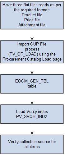

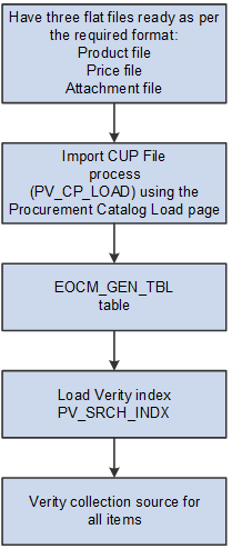

Express Catalog Load Processing
This diagram illustrates the flow for loading express catalog files:
The process flow for loading express catalog items
