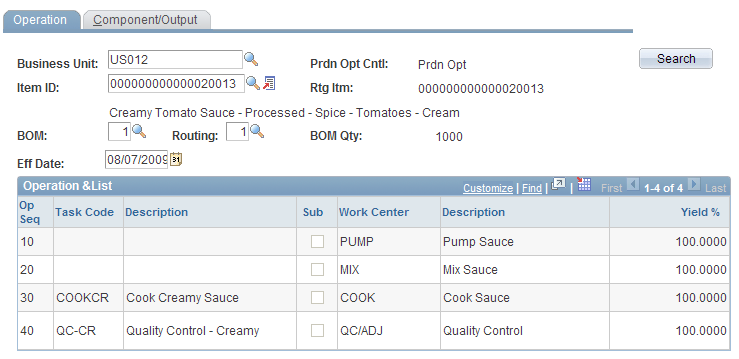

Use the Component/Output Mix - Operation (inquiry) page (EN_PDO_INQ_SUM) to enter the search for the component and output mix, and view the routing operation sequences associated with BOM and routing combinations.
You can view operation information such as tasks and work centers.

This example illustrates the fields and controls on the Component/Output Mix - Operation page. You can find definitions for the fields and controls later on this page.
Field or Control |
Description |
Unit and Item ID |
Select the business unit and item ID for the BOM and routing combination that you want to view. |
Click the View Related Links button to select one of these pages:
BOM, Routing, Revision and Eff Date (effectivity date) |
Select the desired BOM, routing, effectivity date, and revision. If the item is revision-controlled, the system pulls the BOM revision data. If it's not revision-controlled, the system sets the effectivity date to today's date. In addition, the system displays the BOM Qty. |
Prdn Opt Cntl (production option control) |
Displays the production option control, which indicates whether the item has been defined as using production options with the Define Business Unit Item - Manufacturing: General page. Therefore, it displays either Prdn Opt (use production option maintenance) or BOM/Rtg (BOM and routing combination defaults). |
Rtg Itm (routing item) |
Displays the item's reference routing. All of the data that appears is for the item's reference routing, if one exists. Note: All of the data that appears is for the item's reference routing, if one exists. |
Search |
Click to populate the operation list. This section displays the operation sequence for the BOM and routing combination that you selected. The page also indicates whether the operation sequence is subcontracted, and displays the work center and its description. In addition, clicking the Search button populates the Component/Output page in this component. |
Note: A production option does not have to exist for you to view the BOM and routing combination data. You view the same information in either case. In addition, use this inquiry for multiple what-if scenarios.
