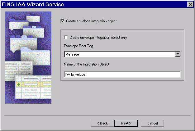

  1. Determine whether or not you only need envelope integration object and select the appropriate option on the FINS IAA Wizard Service dialog box.
  2. Provide a meaningful name for the envelope integration object and click Next.
    Note: It is recommended to use Message as you Envelope Root Tag unless you have customized your .DTD file.
    FINS IAA Wizard Service. In this image, the following check box is selected: Create Envelope integration object. The Envelope Root Tag field has the value Message. The Name of the Integration Object field has the value IAA Envelope.
