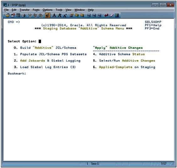

  1. On the Staging Database File Generation Menu, select option 3: Process Additive Components, and press Enter.
    The Staging Database Additive Schema Menu is displayed. The panel ID is SBLSADMP.
    The Staging Database Additive Schema Menu options are: 0. Build Additive JCL/Schema, 1. Populate JCL/Schema PDS Datasets, 2. Add Jobcards and Siebel Logging, 3. Load Siebel Log Entries (3), 4. Additive Schema Status, 5. Select/Run Additive Changes, 6. Applied/Complete on Staging.
  2. Select option 0: Build Additive JCL/Schema, and press Enter,
    Status messages are displayed as the additive components are built.
