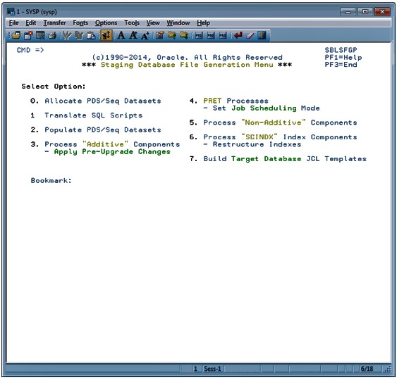

  2. On the Siebel Upgrade Main Menu, select option 1: File Generation, and press Enter.
    The Staging Database File Generation Menu is displayed. The panel ID is SBLSFGP.
    The Staging Database File Generation Menu options are: 0. Allocate PDS/Seq Datasets, 1. Translate SQL Scripts, 2. Populate PDS/Seq Datasets, 3. Process Additive Components - Apply Pre-Upgrade Changes, 4. PRET Processes - Set Job Schedulig Mode, 5. Process Non-Additive Components, 6. Process SCINDX Index Components - Restructure Indexes, 7. Build Target Database JCL Templates.
