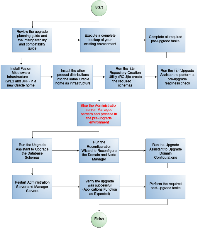

About the Basic 14c Upgrade Process Flow
You should understand the high-level upgrade procedures and tools used to upgrade to the 14c Fusion Middleware Infrastructure.
The flowchart is meant to illustrate a basic upgrade. The tasks you perform to complete your component-specific upgrade may vary from the example shown in this section. The component-specific upgrade documentation provides detailed information about the specific tasks that are required to upgrade the component.About the Basic 14c Upgrade Procedures
Understand the basics of how to upgrade an Oracle Fusion Middleware deployment to 14c (14.1.2.0.0). Consult your component-specific upgrade documentation for the procedures you will perform for your upgrade.
A typical upgrade from the Oracle Fusion Middleware 12c (12.2.1.4.0) release to this Oracle Fusion Middleware 14c (14.1.2.0.0) release is described in this topic. There may be additional steps depending on the components that you are upgrading, but this gives you a general understanding of the upgrade process.
You can find the detailed upgrade procedures in the component-specific upgrade guides.
