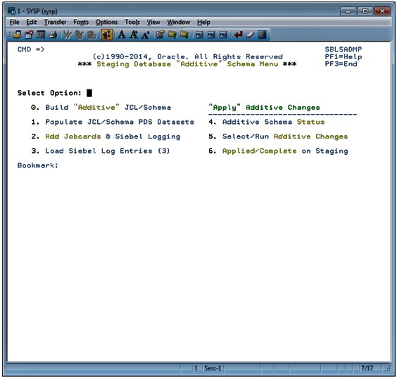

On the Staging Database File Generation Menu, select option 3: Process Additive Components, and press Enter.
The Staging Database Additive Schema Menu is displayed. The panel ID is SBLSADMP.
Select option 0: Build Additive JCL/Schema, and press Enter,
Status messages are displayed as the additive components are built.
On the Staging Database Additive Schema Menu, select option 1: Populate JCL/Schema PDS Datasets, and press Enter.
