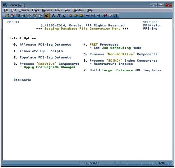

The Staging Database File Generation Menu is displayed. The panel ID is SBLSFGP.
Select option 0: Allocate PDS/SEQ Datasets, and press Enter.

cancelon the command line or press PF3 to save changes.On the Staging Database File Generation Menu, select option 1: Translate SQL Scripts, and press Enter.
This option is used to run the JCL to translate SQL scripts. Language-specific data migration SQL types are translated for PRESCHM, UPGIDSS and Gen Primary jobs.
