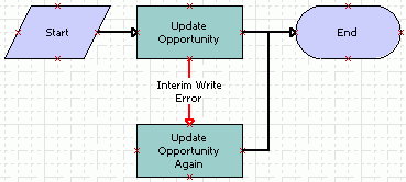

  2. Add the following steps and connectors until your Workflow Process resembles the flow shown in the following figure:
    1. A Start step
    2. An Update Opportunity step
    3. An Update Opportunity Again step
    4. An End step
    5. The following Connectors:
      • A connector between step (a) and (b), (b) and (d), and (c) and (d).
      • An Interim Write Error connector between step (b) and (c).
    Example of adding steps and connectors: This image is described in the surrounding text.
    For more information, see About Step Types and Diagramming a Workflow Process.
