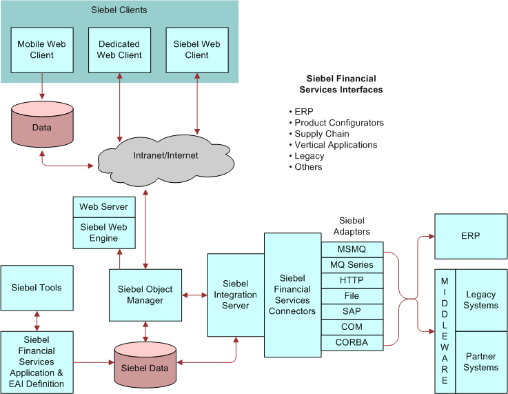

The following image illustrates available Siebel Financial Services interfaces.
Siebel Financial Services Interfaces. In this image, Siebel Clients ( Dedicated Web Client, Siebel Web Client) are connected to Intranet/Internet with two-way arrows. Siebel Client (Mobile Web Client) is connected via Data to Intranet/Internet. Intranet/Internet is connected by two-way arrow to Siebel Object manager which is connected by two-way arrow to Siebel Data. Siebel Object Manager is also connected to Web Server/Siebel Web Engine. Siebel Tools is connected by two-way arrows to Siebel Financial Services Application & EAI Definition. Siebel Financial Services Application & EAI Definition is also connected to Siebel Data. Siebel Data is connected by two-way arrows to Siebel Integration Server, Siebel Financial Services Connectors and Siebel Adapters, MSMQ, MQ Series, HTTP, File, COM, CORBA. Siebel Adapters is connected to ERP and Middleware (Legacy Systems and Partner Systems.)
