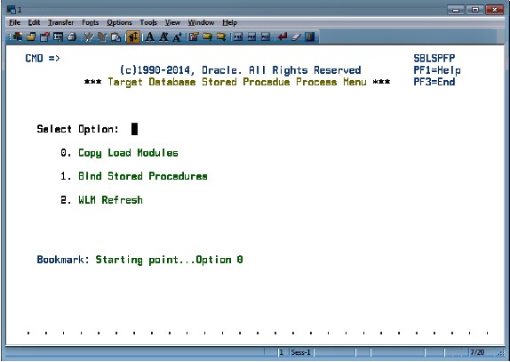

    The Target Database Stored Procedure Process Menu is displayed.
    The Target Database Stored Procedure Process Menu options are: 0. Copy Load Modules, 1. Bind Stored Procedures, 2. WLM Refresh.
  3. On the Target Database Stored Procedure Process Menu, select option 0. Copy Load Modules, and press Enter.
