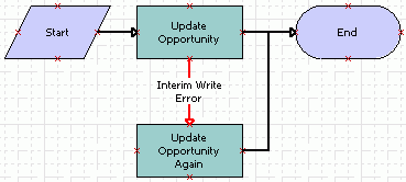

Add the following steps and connectors until your Workflow Process resembles the flow shown in the following figure:
A Start step
An Update Opportunity step
An Update Opportunity Again step
An End step
The following Connectors:
A connector between step (a) and (b), (b) and (d), and (c) and (d).
An Interim Write Error connector between step (b) and (c).

Define the Update Opportunity Again business service step, using the same values you used in step 3 and step 4. For the Name property, use Update Opportunity Again.

The Update Opportunity Again step allows Siebel CRM to write to the opportunity again if the first attempt to update the opportunity fails due to the update conflict error. This example uses a business service step that updates opportunities. You can use the same configuration with other step types that update a record, such as a Siebel operation step or a sub process step, and with other types of records, such as accounts or contacts.
