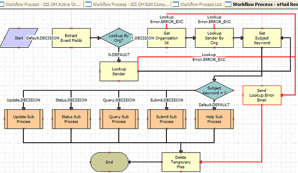

The following image illustrates an example of handling an error exception using an Error Exception connector. In the example shown in this image:
If the Get Organization ID step cannot get data, then the Workflow Process continues to the Lookup Sender by Org step.
If this step (Lookup Sender by Org) fails, then the Workflow Process runs the Error Exception connector and uses the Send Lookup Error Email step to send an email.
