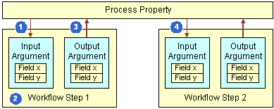

A property set is a hierarchical structure that contains name and value pairs, known as properties, at each level in the hierarchy. The process property stores data that is associated with the property set. A Workflow Process uses a property set to send data to and from a Workflow Process step.
The following figure describes how Siebel CRM uses a process property in a Workflow Process.
As illustrated in this figure, Siebel CRM typically does the following when it uses a process property in a Workflow Process:
The process property sends data to Workflow Step 1 as an input argument.
Workflow Step 1 modifies the data according to the configuration for Step 1.
An output argument on Workflow Step 1 sends data from the step to the process property.
An input argument on Workflow Step 2 brings the data that Step 1 uses into Workflow Step 2, where the Workflow Process can use it according to the internal configuration that is defined for workflow Step 2.
