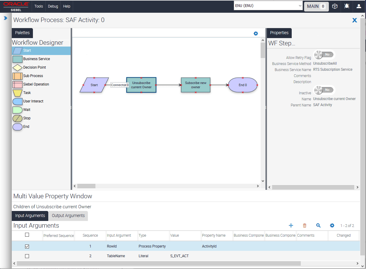

The example MVPW pane in the following figure shows the input arguments
(RowId and TableName) for the Unsubscribe Current Owner
step.
