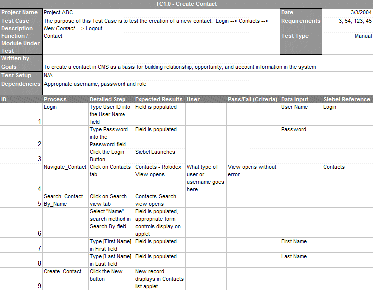

Test Case
A test case describes the actions and objects that you want to test. A case is presented as a list of steps with the expected behavior at the completion of a step. The following image shows an example of a test case.
In the Detailed Step column, there are no data values in the step. Instead you see a parameter name in brackets as a place holder. This parameterization approach is a common technique used with automation tools, and is helpful for creating reusable test cases.
