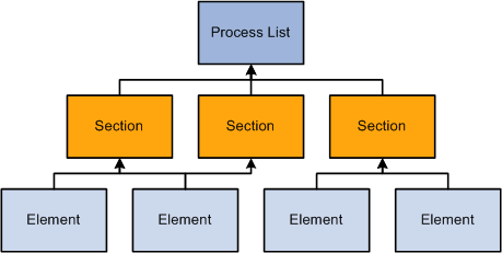

Before creating a process list, you define the sections to include in the process, grouping sets of elements into sections for addition to your process list. In your process list, you can use conditional logic to specify when each section is executed.
This diagram illustrates the relationship between elements, sections, and process lists.
You can create multiple process lists for absence processing. For example, you can create a separate process list for entitlement and take or create one process list that handles both, depending on how you run your processes.

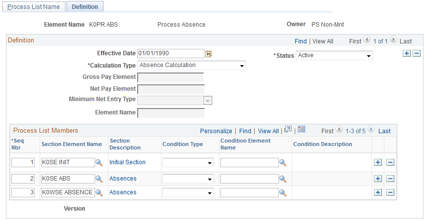

Use the Process Lists -Definition page (GP_PROCESS) to identify sections comprising the process list and the order of execution.
Navigation:
This example illustrates the fields and controls on the Process Lists -Definition page.
Field or Control |
Description |
Calculation Type |
The system displays Absence Calculation. You cannot change this value. |
Gross Pay Element |
This field does not apply. It is used with Global Payroll only. |
Net Pay Element |
Minimum Net Entry Type |
Minimum Net Element |
Process List Members
Field or Control |
Description |
Section Element Name |
Select the name of the section that you're adding. You can use a section only once in a process list, but you can add the same section to more than one process list. |
Condition Type |
Select Formula or Variable to specify a condition for resolving the section that you're adding to the process list. |
Condition Element Name |
Required if you selected a condition type. Select the name of the element that defines the condition. If the element resolves to zero, the condition is considered false and the section isn't resolved. If the element resolves to a nonzero value (for example, -2, -1, 1, or 2), the condition is considered true and the system tries resolving the section. |
