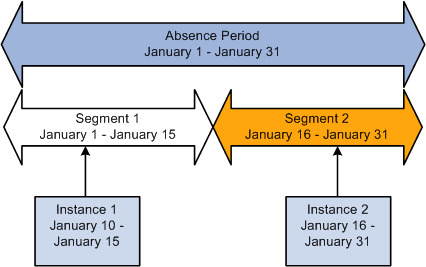

When you run the take process, the system assigns an instance number to each event, based on the following rules:
If Multiple Instances is selected on the Absence Take - Calculation page, the system assigns a separate instance number to each like event that falls within the same absence period.
If Multiple Instances is not selected, the system assigns the same instance number to all like events that fall within the same absence period.
When the absence element that is associated with the take element is segmented, the take process creates multiple instances, regardless of whether you selected Multiple Instances. Multiple instances are also created if the percent defined for the take element changes. (Percent is defined on the Generate Positive Input Member List on the Absence Take - Day Formula page.)
Example
Payee A is absent from January 10 to 17. The absence element is segmented as shown below. The event is divided into the two instances.
This graphic illustrates how the system divides an event into multiple instances due to segmentation.

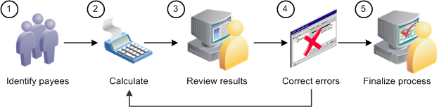

This illustration shows the absence processing steps.
Here are the steps for processing absences (use the Payroll/Absence Run Control page for steps 1, 2, and 5):
Identify payees (Identify phase).
The absence cycle begins when you run a process that identifies all payees that are to be processed.
Perform calculations (Calculate phase).
This phase computes each payee’s absence take or entitlement units for an absence run.
Review results.
If the system encounters problems during the Calculate phase—for example, invalid element definitions or payee eligibility problems—it places the payee in error. You can use various pages to review summary results, errors, and warning messages.
Correct any errors and recalculate.
To correct errors, you may need to update the Positive Input pages or make changes to the data in other applications that are integrated with Absence Management, such as HR or Time and Labor. You can then run the Calculate phase again to process only the payees that need to be recalculated.
Finalize the run.
When you’re satisfied with the processing results, run the Finalize phase to close the calendar group ID.

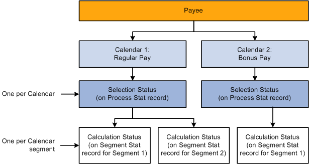

Status codes and process indicators play an important role in absence processing. Status codes help you monitor and interpret the processing results; process indicators enable you to manually enter processing instructions for specific payees. This section focuses on how the codes are created and how to interpret them.
Status Codes
The system creates two sets of status codes as it identifies each payee for processing:
One selection status code for each payee for each calendar, which it stores on the Process Stat (process status) record. During the first run of the Identify phase, each payee’s selection status is set to Active or Inactive to explain why the payee was identified for processing. With each iteration of the Calculate phase, the system updates the status to explain why the payee was included in or excluded from processing.
The system keeps a record of excluded payees only if they were suspended or canceled. If the payee simply no longer qualifies for selection (for example, the payee is assigned to a different pay group), the system does not record this, and the payee's process and status records are deleted.
One calculation status code for each payee, per calendar segment, which is stored on the Segment Stat record. If a calendar has no period segmentation, a payee has one calculation status. Calculation status tells you the most recent action that has been completed for the segment, for example, identified, calculated, or frozen. Before you run the Calculate phase for the first time, the status code for each identified payee is Identified.
This diagram illustrates the status codes created by the system when payees are identified for processing.
