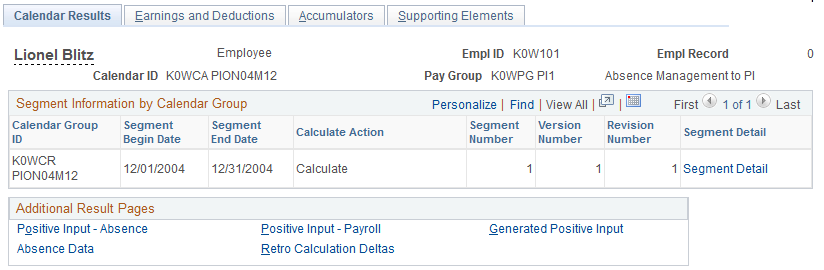

Use the Results by Calendar - Calendar Results page (GP_RSLT_CAL_SEG) to view segmentation information for a payee.
Page includes links to other pages that display positive input, absence, and retroactive results.
Navigation:
This example illustrates the fields and controls on the Calendar Results page.
Field or Control |
Description |
Segment Detail |
Click to display the Result Segment Detail page. |

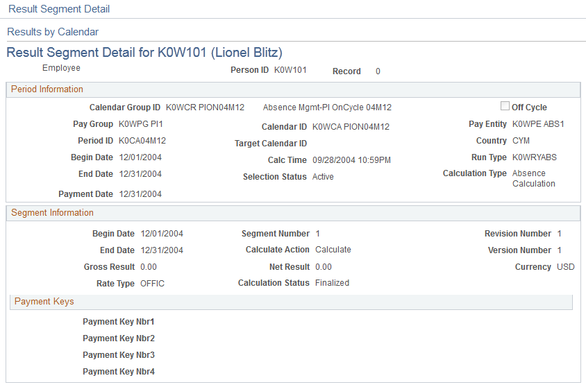

Use the Results by Calendar - Result Segment Detail page (GP_RSLT_SEG_SP) to view more information about a segment’s process and segment statuses.
Navigation:
This example illustrates the fields and controls on the Results by Calendar - Result Segment Detail page.
Period Information
Field or Control |
Description |
Period ID |
The ID for the time period that is covered by the calendar. |
Begin Date and End Date |
The begin and end dates that are associated with the Process Stat record. The dates match the calendar begin and end dates. |
Target Calendar ID |
The target calendar that you selected when defining the calendar for this calendar run. |
Calc Time (calculation time) |
The last time that calculations were run for this payee. |
Segment Information
Field or Control |
Description |
Rate Type |
The exchange rate type associated with the payment. (You define the exchange rate type on the Pay Group Name page and can override it by payee.) |
Calculation Status |
Values are: Active in Segment: Payee was active for at least one day during the calendar segment. Inactive in Segment: Payee was not active during that time period. |
Transaction Type |
Appears for off-cycle results. Values are Correction and Advance. |
Payment Keys
This group box displays any payment keys that have been defined for the payee’s pay entity.

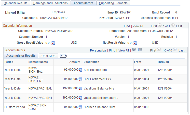

Use the Results by Calendar - Accumulators page (GP_RSLT_CAL_ACUM) to view accumulator amounts.
Navigation:
This example illustrates the fields and controls on the Results by Calendar - Accumulators page.
Accumulator Results
Field or Control |
Description |
Period |
The period of time tracked by the accumulator. |
User Keys
This tab displays the system element or variable element that is associated with the user keys for each accumulator.

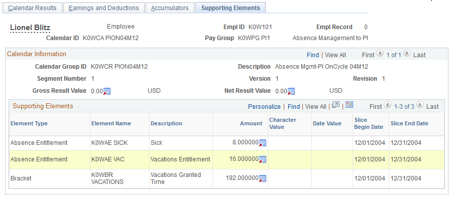

Use the Results by Calendar - Supporting Elements page (GP_RSLT_CAL_PIN) to view information for each supporting element that was used to calculate absence results.
Navigation:
This example illustrates the fields and controls on the Results by Calendar - Supporting Elements page.
The type of value that the supporting element resolved to determines the column that it is listed under Amount, Character Value, or Date Value.
Field or Control |
Description |
Slice Begin Date and Slice End Date |
The begin and end dates of the slice in which the supporting element was resolved. |
