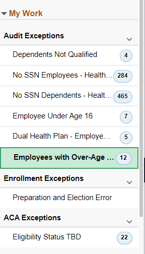

The My Work group box provides Benefits work item links for exceptions in these group sections:
Audit Exceptions
Enrollment Exceptions
ACA Exceptions
PeopleSoft provides these sample exceptions which you can use, modify or clone to suit your organization's business needs.
This example illustrates the fields and controls on the My Work Group Box.
Note: Work item links are grayed out if no data is available for display.
Audit Exceptions
The PeopleSoft-delivered Audit Exceptions link provides reports of exceptions similar to what is provided in BEN733.SQR. These include:
Dependents Not Qualified
No SSN Employees–Health Benefits
No SSN Dependents–Health Benefits
Employees Under Age 16
Dual Health Plan–Employee/Dependent
Employees with Over-Age Dependents
The PeopleSoft-delivered Enrollment Exceptions link provides a report (Preparation and Election Error) to fetch all processing messages similar to what is in the Benefits Administration Processing messages.
ACA Exceptions
The PeopleSoft-delivered ACA Exceptions link provides an audit report (Eligibility Status TBD) that fetches any ACA Employee who does not have an ACA Eligibility Status defined.

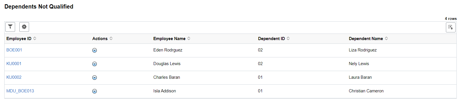

Use the Dependents Not Qualified page to view the employees having non qualified dependents.
This example illustrates the fields and controls on the Non Qualified Dependents page.

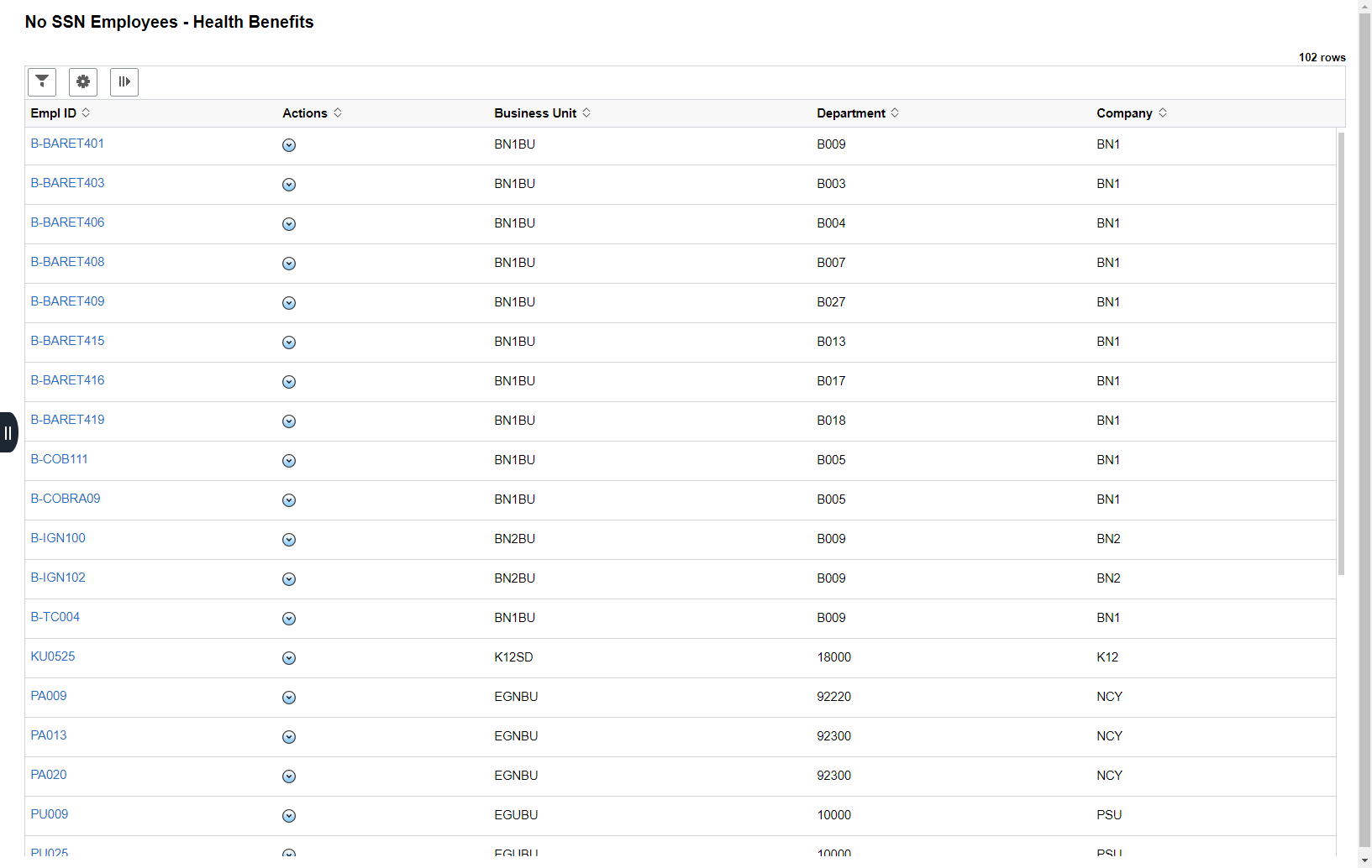

Use the No SSN Employees–Health Benefits page to get a report of health benefits of the U.S. employees with missing National IDs.
This example illustrates the fields and controls on the No SSN Employees–Health Benefits Page.

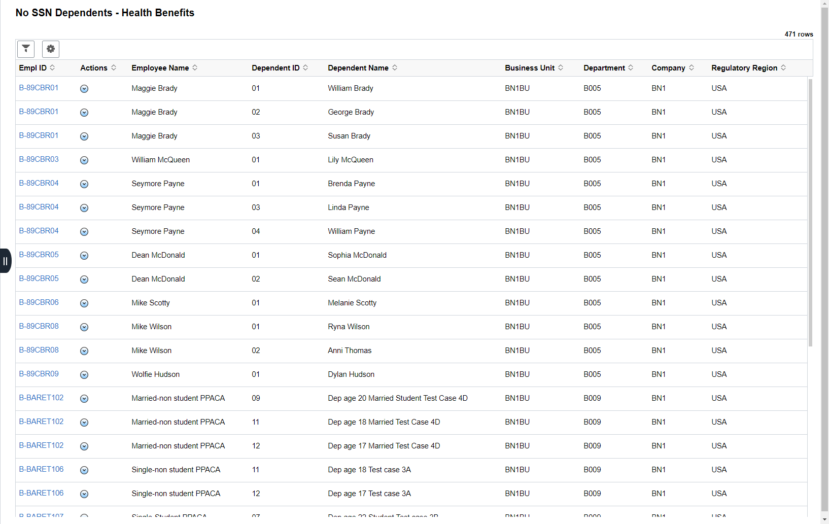

Use the No SSN Dependents–Health Benefits page to get a report of the U.S. health benefits dependents with missing National IDs.
This example illustrates the fields and controls on the No SSN Dependents–Health Benefits Page.

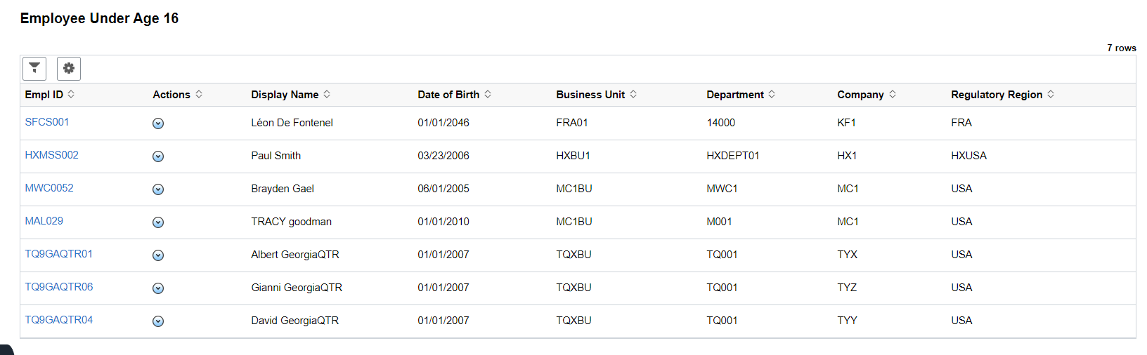

Use the Employee Under Age 16 page to get a report of employees, like interns, under the age of 16, or to pull up incorrect records where date of births were entered wrong.
This example illustrates the fields and controls on the Employee Under Age 16 Page.

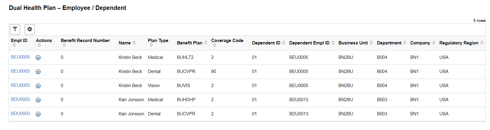

Use the Dual Health Plan–Employee/Dependent page to fetch a report to find out if the employee and spouse or dependent work in the same company and if both are enrolled in health plans.
This example illustrates the fields and controls on the Dual Health Plan–Employee/Dependent Page.

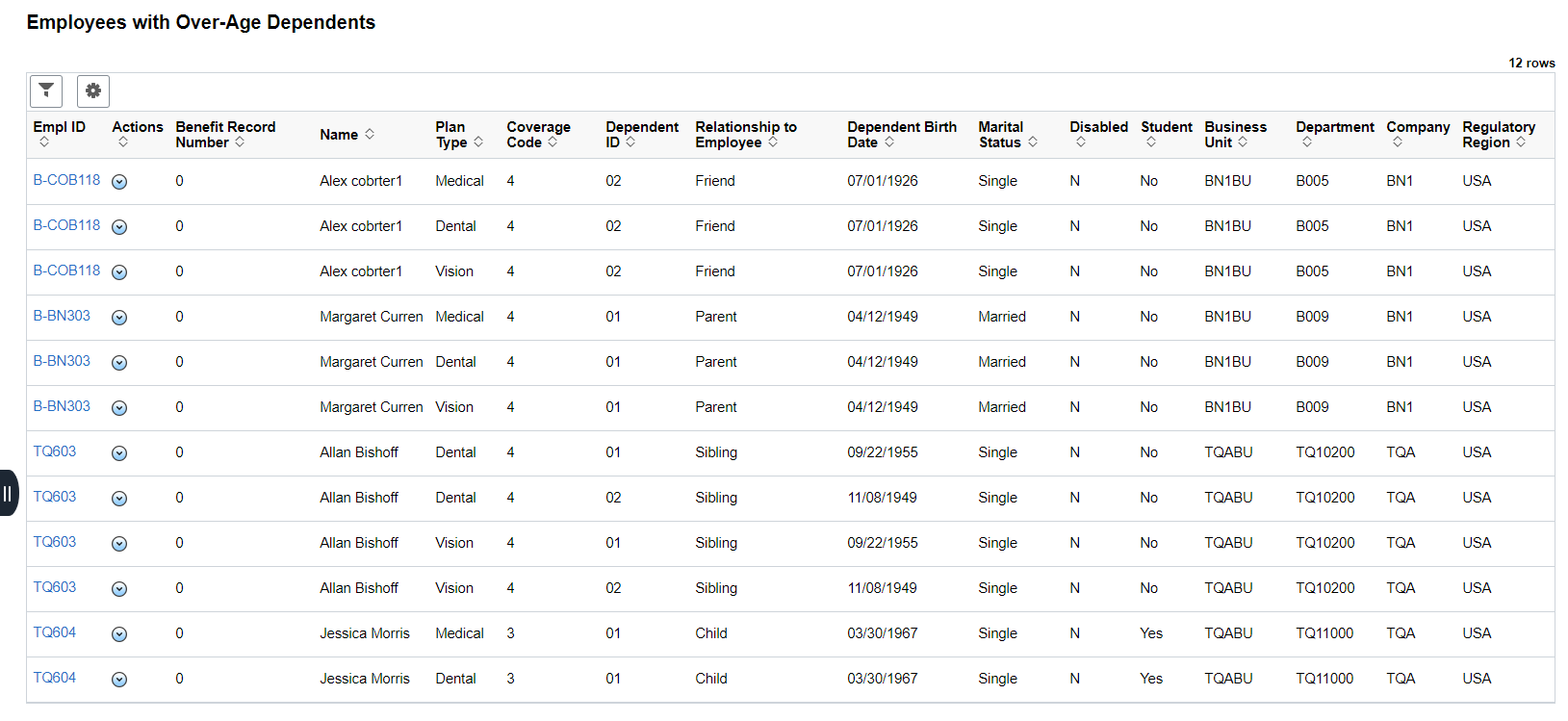

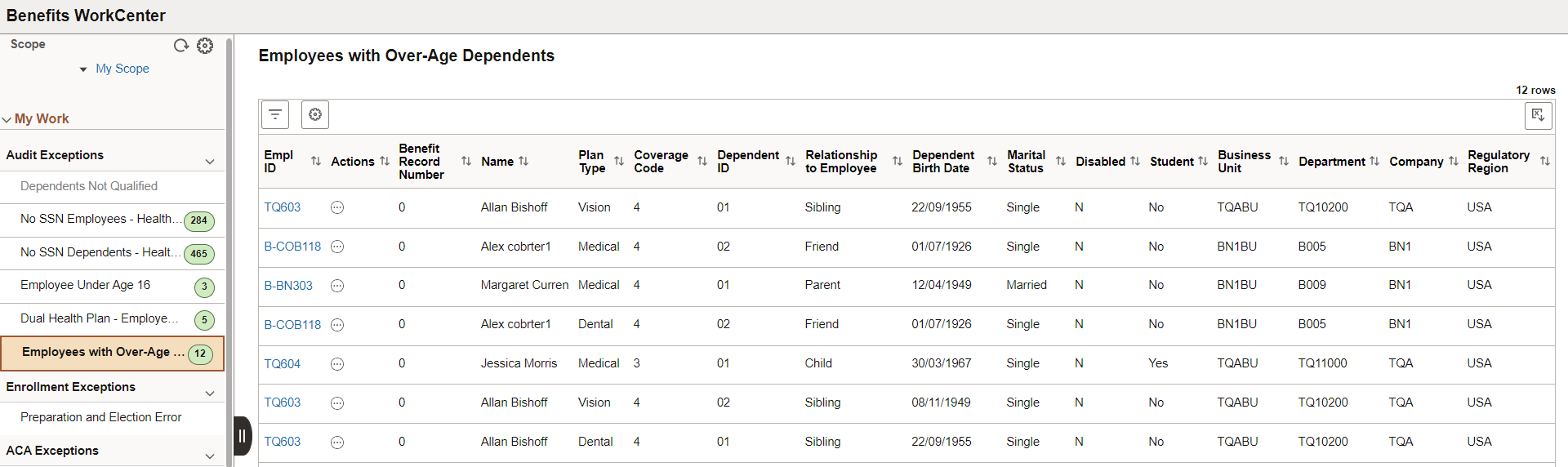

Use the Employees with Over-Age Dependents page to get a list of dependents of employees who are over the age as based on the Dependent Rules Table Page.
This example illustrates the fields and controls on the Employees with Over-Age Dependents Page.

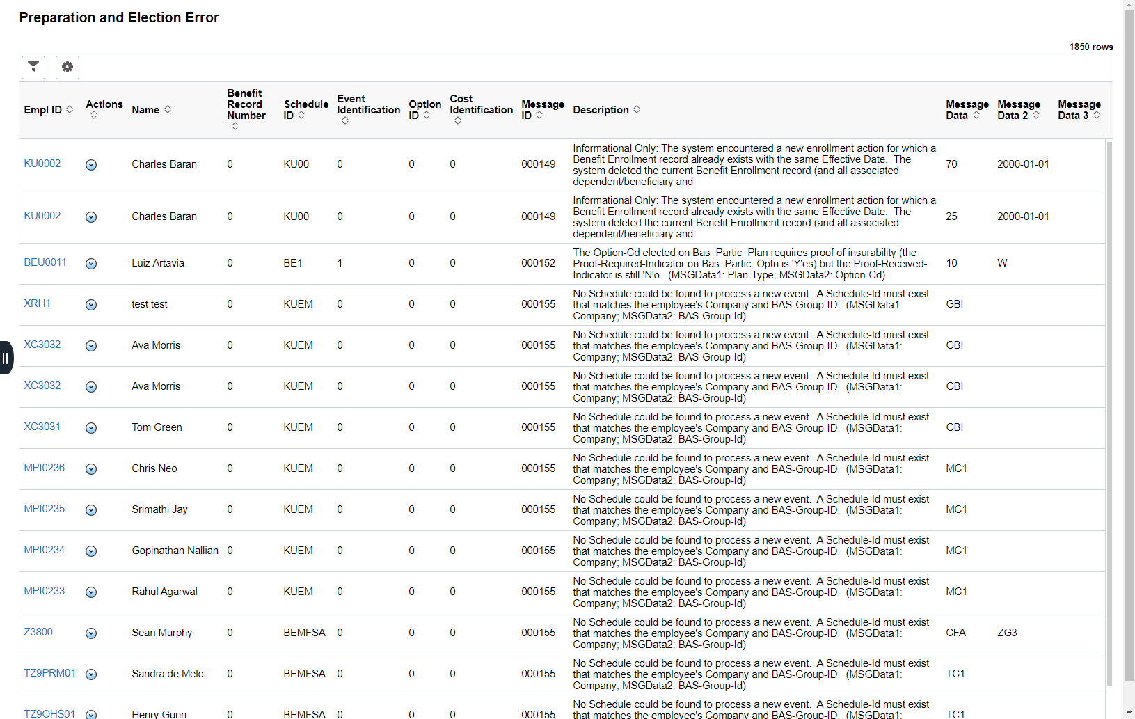

Use the Preparation and Election page to get reports on errors appearing during preparation and election of benefit plans.
This example illustrates the fields and controls on the Preparation and Election Error Page.

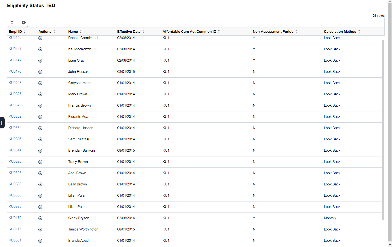

Use the Eligibility Status TBD page to get a report on the employees with the ACA eligibility status as “To be Determined”.
This example illustrates the fields and controls on the Eligibility Status TBD Page.

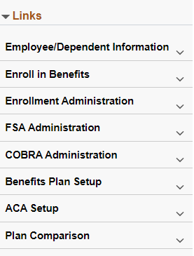

The Links group box provides access to the key components in Benefits. It contains links that users need to do their daily benefits-related work.
This example illustrates the Links Group Box.
System administrators can manage links and configuration options for the Links Group Box on the Configure Pagelets - Links Page.

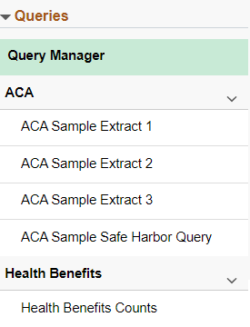

The Queries group box contains:
The Query Manager link
Users can click this link to search for existing queries or create new ones to use.
ACA queries
Health Benefits queries
This example illustrates the Queries Group Box.
Administrators can manage links and configuration options for the Queries Group Box on the Configure Pagelets – Queries Page.
