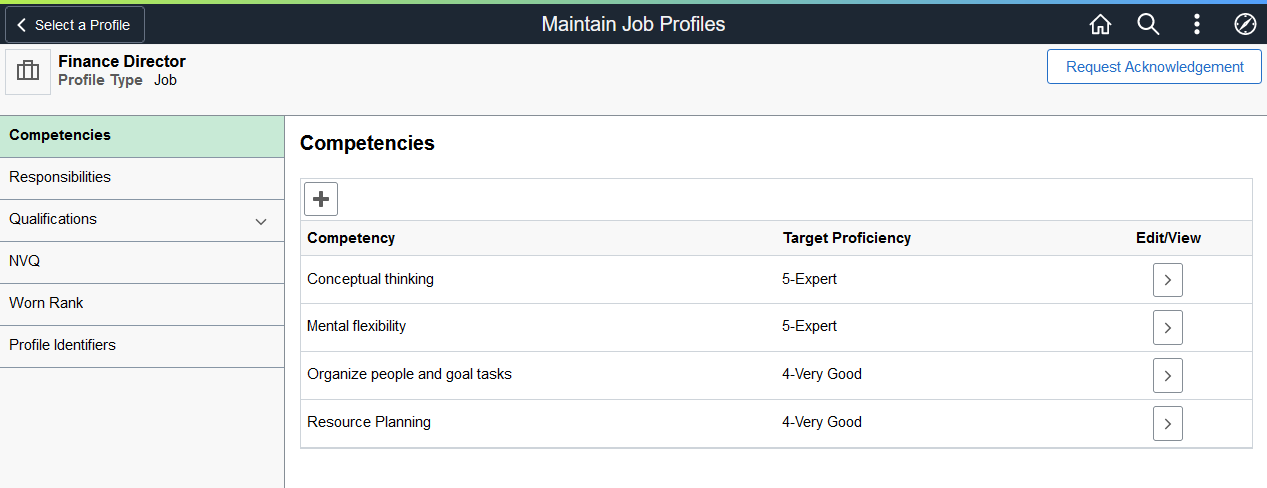

(Managers) The Request Acknowledgement button appears for managers on the Maintain Job Profiles page when the profile type and identifier has been configured to participate in the acknowledgement process on the Profile Types - Identities Page.
This example illustrates the Maintain Job Profiles page showing the Request Acknowledgement button.
Field or Control
Description
Select this button to submit a request that employees acknowledge the attributes of this job profile. This can be done any time but is beneficial when changes have been made to the profile.
Note: The request is not automatically sent to employees. When you select the Request Acknowledgement button, an event is raised in Event Manager. The event handler processes the request and stores it for the next run of the Run Acknowledgements process (see the Run Acknowledgement Request Page).
By running the Run Acknowledgements process, all statuses for all employees associated with the profile will be reset to Not Acknowledged, and the Action Required notices and Acknowledge badges with be available from the My Job Profiles pages, even if the employee has acknowledged the profile in the past.
Managers can view the status of their direct and indirect reports on the Acknowledgement Status Page.
