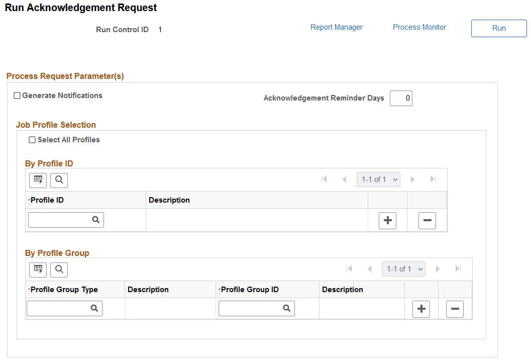

Use the Run Acknowledgement Request page (JPM_ACK_REQ_RC) to create acknowledgement requests for all employees associated with job-related (non-person) profiles participating in the job profile acknowledgement process.
Navigation:
From the Administer Workforce home page in fluid, select the .
This example illustrates the fields and controls on the Run Acknowledgement Request page.
This process identifies:
Profile types with the Request Acknowledgement option enabled on the Profile Types - Identities Page and those non-person profiles to which they are associated.
Manager or administrator requests made from the following locations:
(Manager) Request Acknowledgement button at the top of the Maintain Job Profiles page (see My Job Profiles Page (for Employees), View Job Profiles Page (for Employees), and Maintain Job Profiles Page (for Managers)).
(Administrator) Request Acknowledgement action from the Non-person Profile Page, Profile Actions field.
All employees tied to participating non-person profiles and sends a notification, if configured to do so.
After the process runs, the My Job Profile tile and pages will display Action Required badges and an Acknowledge button for participating job profiles.
Managers can view the status of these acknowledgements using the Acknowledgement Status Page.
Administrators use the Review Acknowledgements Page in the Acknowledgement Framework to view job profile acknowledgements.
Field or Control |
Description |
Generate Notifications |
Select this check box to send an email notification to employees to review their job profile. This notification will be sent only to those associated with the job profiles picked up by the Request Acknowledgement process. |
Acknowledgement Reminder Days |
Enter the number of days after the initial acknowledgement request was sent that a reminder notification should be sent to employees. For example, if you enter 5, and the employee has not yet acknowledged the job profile after five days, then the system will send out the reminder email. |
Job Profile Selection
Field or Control |
Description |
Select All Profiles |
Select this check box to run the process for all participating job profiles. Participating profiles are non-person profiles that have the Request Acknowledgement option selected on the Profile Types - Identities Page for at least one of it's identities. When you select this option, the remaining fields in this section are hidden. |
Profile ID and Description |
Enter individual profile IDs for which you want to run the acknowledgement process. The process creates acknowledgement requests for employees associated with profiles that are configured for acknowledgements. For information on setting up non-person profiles, see the Non-person Profile Page documentation. |
Profile Group Type and Description |
Select a profile group that will contain the set of profiles for which you want to run the acknowledgement process. When you select a group type, you need to enter at least one group ID from that group type. For information on creating groups, see the Creating Profile Group Types and Profile Groups documentation. |
Profile Group ID and Description |
Select a group ID from the group type you entered. The process creates acknowledgement requests for employees associated with job-related profiles in the group that are configured for acknowledgements. |
