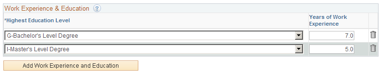

Use the Work Experience & Education section on the Job Opening page (HRS_JOB_OPENING) to specify the work requirements for applicants with varying levels of education.
Note: The template for the job opening controls whether this section appears and, if so, where it appears.
Use this grid to set up a matrix showing how many years of experience are required for applicants with different education levels.
Field or Control |
Description |
Highest Education Level |
Select an education level so that you can then enter the amount of experience required by applicants who have selected the same value as their highest level of education. Education levels are defined on the Education Level Achieved Table page. Note: When you use Education & Experience requirements as screening criteria, applicants with a higher education level than the one you selected are not considered to have met the requirement. To prevent the system from penalizing applicants with more education than you require, create additional rows for every degree above the minimum requirement. |
Years of Work Experience |
Enter the years of work experience required for applicants with the specified level of education. Leave this field blank to indicate that there are no experience requirements for applicants who have attained the given education level. Note: When the screening process evaluates whether an applicant meets particular education & experience requirements, it fails applications where there are no work experience entries with start dates, even if there are zero years of work experience required. |
Add Work Experience and Education |
Click to add another row to the Work Experience & Education grid. |

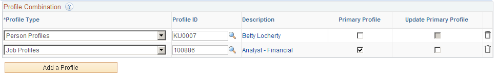

Use the Profile Combination section on the Job Opening page (HRS_JOB_OPENING) to review the profiles from which job qualifications were imported.
Note: The template for the job opening controls whether this section appears and, if so, where it appears. This section is only available for inclusion in the job opening template if the system is configured for profile integration.
Navigation:
Click the Continue button on the Primary Job Opening page and, if necessary, on the Combined Profile Information page.
Click the link for a job opening in the search results, then click the Job Details tab, then click the link for the type of job opening data you want to access.
This example illustrates the Job Opening page: Profile Combination Section.
This section displays the same Profile Combination grid that appears on the Combined Profile Information Page. The grid lists the profiles whose content items were copied into the job opening. However, here on the Job Opening page, you can add and remove profiles from the grid. If you remove a profile , the system removes all items related to that Profile ID from the job opening. If you add an additional profile, the system copies the additional items from that profile into the job opening.
Note: Approvers cannot modify the data in the Profile Combination grid. They can, however, change, add, or delete the individual content items that appear in profile-related grids.
The Description column includes a link that you click to access the profile details; the link is disabled for person profiles when you do not have security access to view that person's profile.

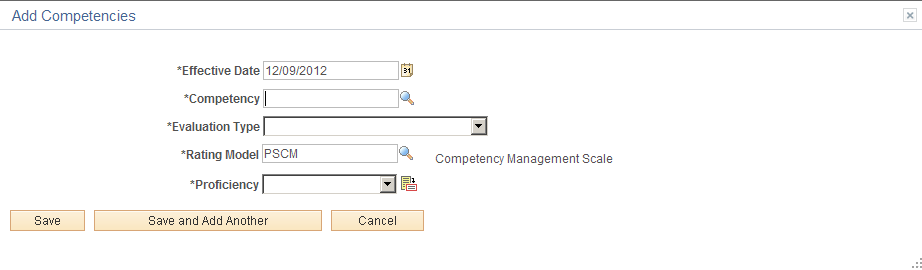

Use the Add <Profile Content Type> page or Update <Profile Content Type> page (HRS_PROF_DETAIL) to enter detailed information about a profile content item that is being used as a job qualification.
Navigation:
Click the Add <profile content type> link that is associated with a profile-related grid in a job opening.
Click an existing profile content item in a profile-related grid.
This example illustrates the Add <Profile Content Type> page. In this example, the page is used to add competency data, so the page title is Add Competencies. The same fields appear when you access an existing competency, but the page title changes to Update Competencies.
Note: The page name and the fields on the page vary depending on the content type.
Field or Control |
Description |
Save |
Click to save changes and return to the Job Opening page. |
Save and Add Another |
This button appears only when you are adding a new content item. Click the button to save changes and display the page in a fresh state so you can add an additional content item. Although the job opening page is visible behind the Add <Profile Content Type> page, it does not refresh until you close the Add <Content Type> page. Therefore, content items that you save using this button do not immediately appear in the job opening. |
Cancel |
Click to return to the Job Opening page without saving any changes to the current row. If you previously used the Save and Add Another button, the data that was already saved is not canceled. |
