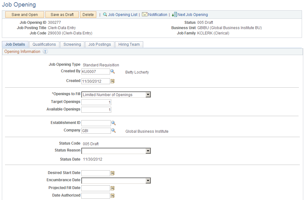

The following illustrations show how a job creation can simplify a hiring manager’s experience when the manager must enter a limited amount of data in a draft job opening.
This example shows the first few fields of a draft job opening as a hiring manager would see it without the benefit of a flexible job creation process. Many more fields appear after the ones shown here.
This example shows a draft job opening as a hiring manager would see it when the flexible job creation process shows hiring managers a small subset of the job opening fields. Note that the flexible recruiting process does not hide tabs even when the user cannot see any fields on a tab.

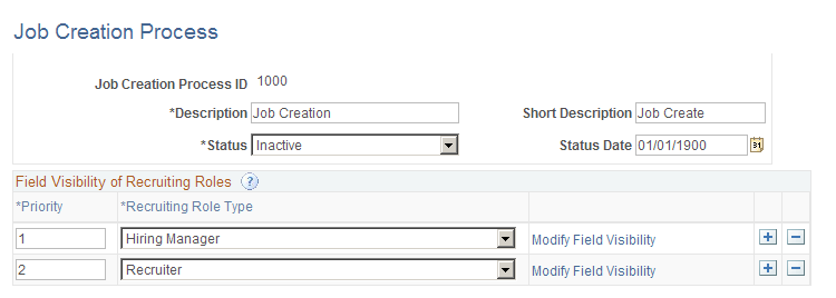

Use the Job Creation Process page (HRS_JCP_DEFN) to set up a process that controls which job opening fields are visible to users with different recruiting roles.
Navigation:
This example illustrates the Job Creation Process page.

Field Visibility of Recruiting Roles
Field or Control |
Description |
Priority |
Enter a priority to control which role’s settings to use when a person has more than one recruiting role type. Lower numbers have higher priority. For example, if you give the Recruiter role priority 1, and you give the Hiring Manager priority 2, then a user who has both roles will use the settings associated with the Recruiter role. |
Recruiting Role Type |
Create a row for each recruiting role type that you will associate with field visibility settings. Recruiting role types are functional groups of PeopleTools roles such as Recruiters and Hiring Manages. Use the Recruiting Roles Page to choose which PeopleTools roles belong to each recruiting role type. The drop-down list box shows only recruiting role types that are associated with at least one PeopleTools role. The list does not include the Recruitment Administrator role type because administrators are never subject to flexible process restrictions. Users without any of the roles you specify will not be subject to flexible process restrictions. For example, if you create a row for hiring managers so that they see only a subset of job opening fields, but you do not create a row for recruiters, then recruiters who are not also hiring managers will see all of the job opening fields. If you want recruiters who are also hiring managers to see all fields, you should also create a row for the recruiter role type. |
Configure Field Visibility and Modify Field Visibility |
Click this link to access the page where you configure field visibility for a recruiting role type. For recruiting role types that do not yet have field visibility settings, the link text and the page name are Configure Field Visibility. After you save field visibility settings, the link text and the page name are Modify Field Visibility. |

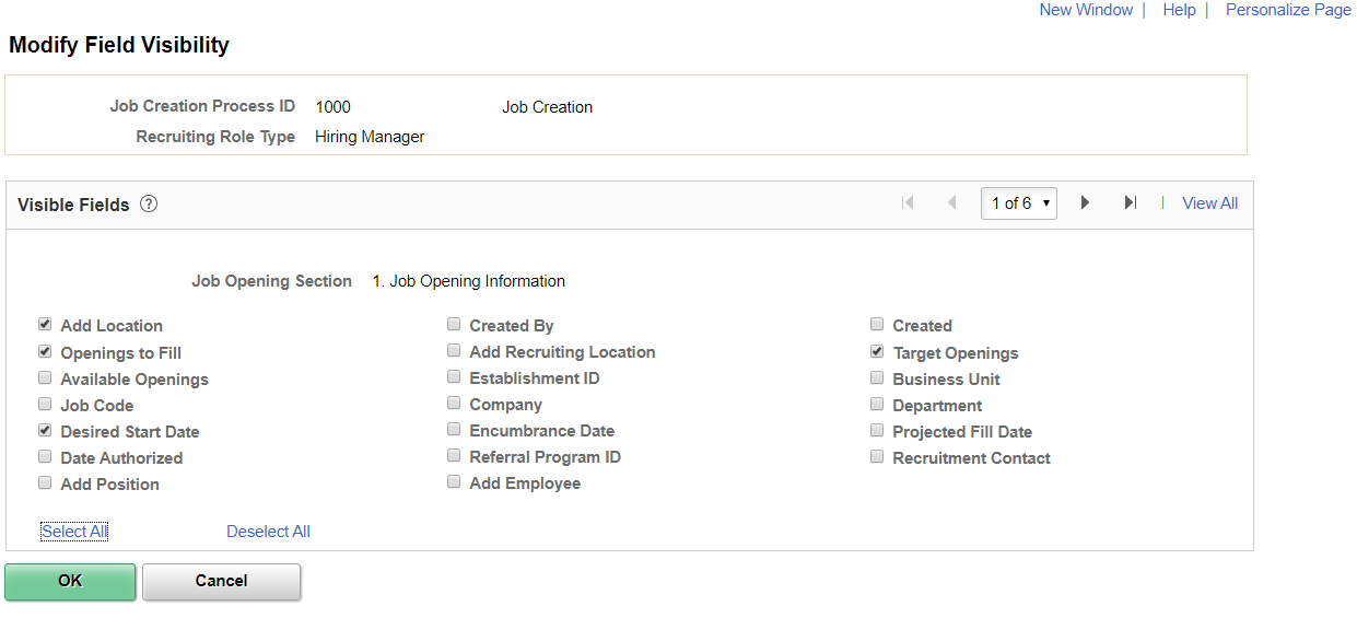

Use the Configure Field Visibility page (HRS_JCP_FLD_CONFIG) to define detailed field visibility settings for a single recruiting role type.
Navigation:
On the Job Creation Process page, click the Configure Field Visibility link for a role type that has not yet been configured, or click the Modify Field Visibility link for a role type that was previously configured.
This is the first of three examples illustrating the Configure Field Visibility page.
When you access this page, you initially see only the first of six group of fields. You can scroll through the groups, or, to expand the page so that all sections are visible (as in these examples), click the View All link.
This is the second of three examples illustrating the Configure Field Visibility page.
This is the third of three examples illustrating the Configure Field Visibility page.
Note: (USF) Additional fields are available for configuration in a US Federal system.
This page includes six sections, each with check boxes that represent fields or grids for a particular area of the Create Job Opening page. Select a check box to make the field or grid available to users with the specified recruiting role type.
