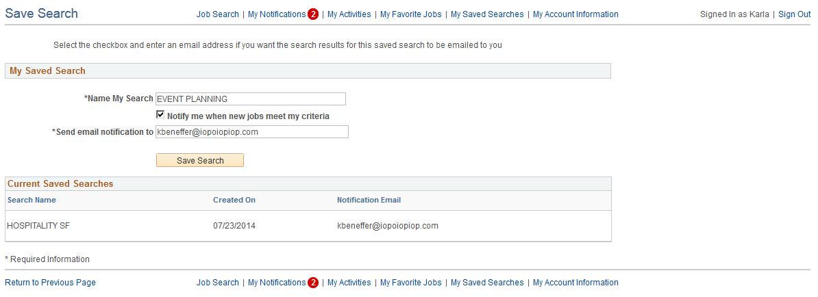

Applicants use the Save Search page (HRS_APP_SAV_SCH) to save search criteria and to request email notifications with search results.
Navigation:
Click the Save Search button on the Job Search page (after entering search criteria).
This example illustrates the Save Search page.
My Saved Search
Field or Control |
Description |
Name My Search |
Applicants enter a unique name to identify the saved search. |
Notify me when new jobs meet my criteria |
Applicants select this check box to save the search criteria as a job agent. If the applicant already has the maximum number of job agents (configured in the Maximum Job Agents field on the Recruiting Installation – Applicants Page), the system issues an error, and the applicant must deselect the check box before saving. |
Send email notification to |
If the search is being saved as a job agent, the applicant must supply an email address for the job agent email notifications. The applicant’s primary email address is the default value. |
Save Search |
Clicking this button saves the search. |
Current Saved Searches |
This grid lists the applicant’s existing saved searches to provide context for the current saved search. Reviewing existing saved searches helps applicants choose a unique name for the Name My Search field. |

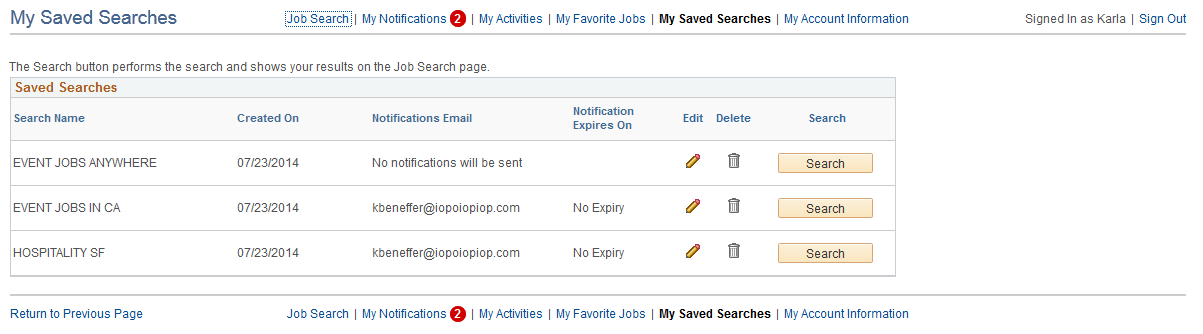

Applicants use the My Saved Searches page (HRS_APP_SEARCHES) to view, edit, delete, and run saved searches.
Navigation:
Click the My Saved Searches link in the navigation bar that appears on pages throughout Candidate Gateway if the applicant is signed in.
Click the Save button on the Save Search page.
This example illustrates the My Saved Searches page.
Saved Searches
Field or Control |
Description |
Search Name |
Displays the unique search name entered by the applicant. |
Created On |
Displays the date that the applicant created the saved search. |
Notifications Email |
If the search was saved as a job agent, this field displays the email where job agent notifications are sent. Otherwise, this field displays the message No notifications will be sent. |
Notification Expires On |
If the Days Job Search Agent Active setting on the Recruiting Installation – Applicants Page has a value, then searches that were saved as job agents expire after the specified number of days. The expiration date is shown here in the Notification Expires On field so that the applicant is aware of the expiration date. The expiration date is also given in the email notifications that the job agent process sends to the applicant. This column is blank for searches that are not job agents. |
Clicking this icon displays the Edit Search Page, where the applicant can modify search criteria and job agent settings. The Edit button is not available for searches that were saved before the introduction of faceted searching in Candidate Gateway. However, applicants can still run these legacy searches. |
Clicking this icon deletes a saved search. An alternative to editing a saved search is to delete the original search and create a new one. |
Search |
Clicking this button performs the saved search. The Job Search Page appears and displays both the search criteria and the search results. |

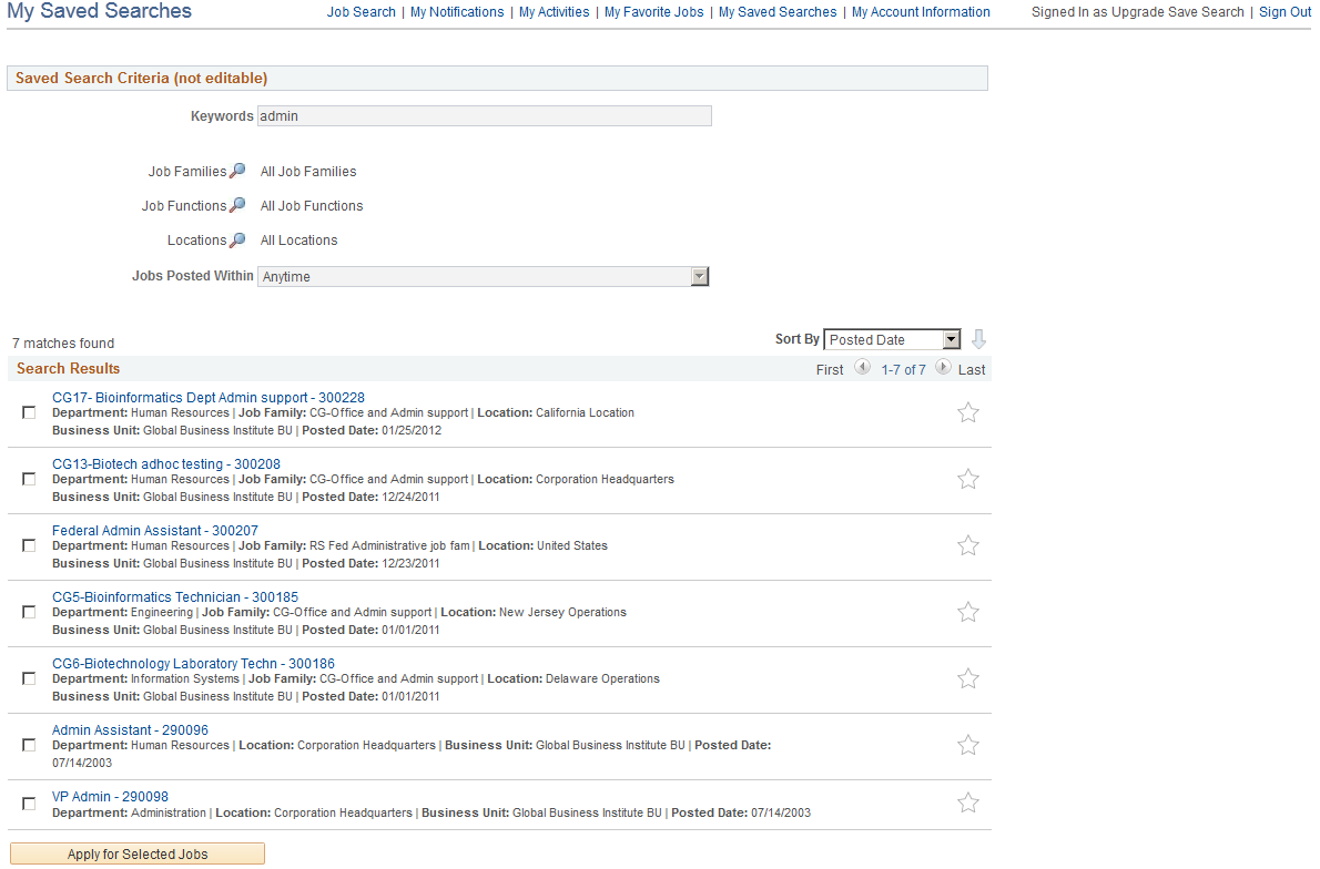

Use the My Saved Searches (legacy search results) page (HRS_APP_SCHJOB_NF) to view the results of a search that was saved before the introduction of faceted searching in Candidate Gateway.
Navigation:
On the My Saved Searches page, click the Search button for a saved search that was created before the introduction of faceted searching in Candidate Gateway. You can recognize a legacy search by the disabled Edit icon.
This example illustrates the My Saved Search page that shows search results for legacy searches.
Field or Control |
Description |
Saved Search Criteria (not editable) |
This area of the page displays the original search criteria. |
Search Results |
The Search Results list for a legacy search are the same as the Search Results list on the Job Search page. Applicants can sort the list, access job details, and click the My Favorite Jobs icon. Site settings control whether applicants can select and act on multiple jobs. |
