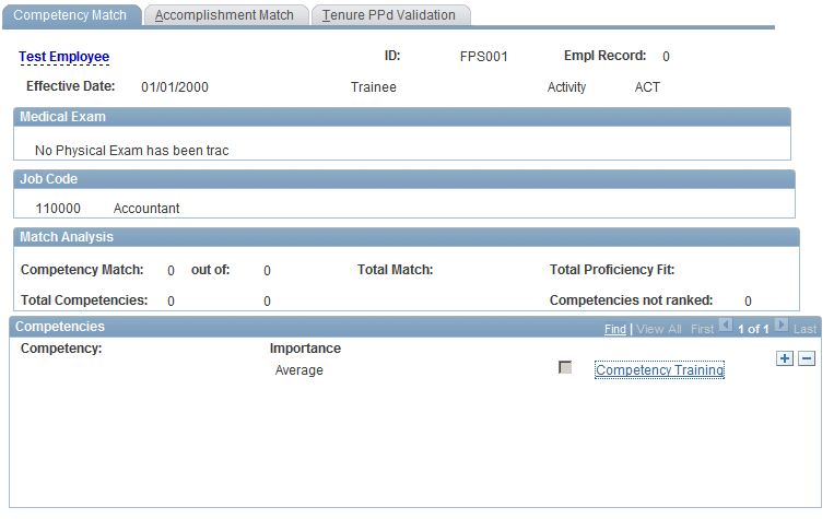

Use the Competency Match page (FPAEETENURE_PNL4) to displays a comparison of the employee's competencies with those that are required by the job.
It also displays the results of the employee's medical examination.

This example illustrates the fields and controls on the Competency Match page. You can find definitions for the fields and controls later on this page.
Medical Exam
This group box shows the last physical exam results. It also indicates if the medical exam has not been tracked.
Job Code
This group box displays the employee's job code and description.
Match Analysis
This group box summarizes the competency match results. The system compares the profile defined for the job code (of profile type ROLE) with the employee's profile (of type PERSON). The competency matching works in the same way as the Person to Role match provided in the Manage Profiles business process.

Competency Match |
Indicates how many points the employee has been awarded out of the total possible for the role. Employees are awarded points if they have a required competency and a proficiency rating that is equal or greater than that required for the job. The number of points awarded for matching competencies depends on the importance level assigned to the competencies in the job profile. |
Total Match |
Displays the maximum number of points available if the employee meets all the competency requirements. |
Total Competencies |
Displays the number of competencies included in the match. |
Total Proficiency Fit |
Displays the employee's points as a percentage of the total possible for the role. |
For more details of how the competency matching works, refer to the PeopleSoft HR: Manage Profiles PeopleBook.
Competencies
This group box lists the competencies that are in the profile for the job specified in the Job Code group box. The match indicator icon shows how well the employee meets the competency. A blue filled circle indicates that the employee possesses the required competency and has the required proficiency rating.

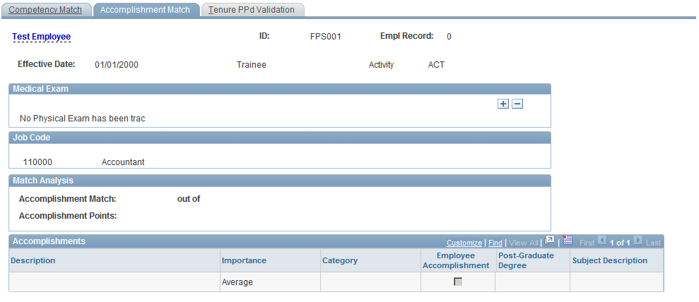

Use the Accomplishment Match page (FPAEETENURE_PNL3) to displays a comparison of the employee's accomplishments with those that are required by their job.
Navigation:
This example illustrates the fields and controls on the Accomplishment Match page. You can find definitions for the fields and controls later on this page.
Medical Exam
Job Code
Displays the employee's job code and job code description.
Accomplishments
This group box lists the accomplishments in the profile for the employee's job.

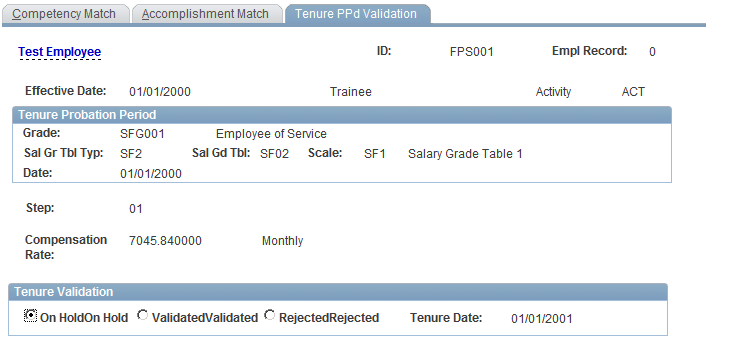

Use the Tenure PPd Validation (tenure probation period validation) page (FPATEN_VALID_PNL1) to validate or reject the tenure probation period.
Navigation:
This example illustrates the fields and controls on the Tenure PPd Validation page. You can find definitions for the fields and controls later on this page.
The page displays trainee grade and step data. In the case of automatic step increment, the next step and corresponding compensation appear.
To validate or reject the tenure probation period, select On Hold, Validated, or Rejected.
Validating the probation period does not imply that the tenure becomes effective; you must still grant tenure.
You can renew a probation period only once. To renew a probation period after the first rejection, select the Status option in the worklist and enter the second probation period length (number of days).
When the probation period is rejected for the second time, the tenure is not validated, and the trainee is terminated.
