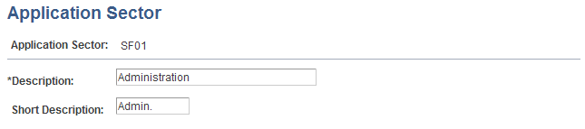

Use the Application Sector page (FPMAPPLAREA_PNL) to define application sector for the salary grade table.
Navigation:
This example illustrates the fields and controls on the Application Sector page. You can find definitions for the fields and controls later on this page.
Enter a description and short description of the application sector.

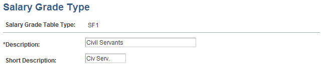

Use the Salary Grade Type page (FPMMATXTYP_PNL) to add or modify salary grade table types.
Navigation:
This example illustrates the fields and controls on the Salary Grade Type page. You can find definitions for the fields and controls later on this page.
Enter a description and short description of the salary grade table type.
