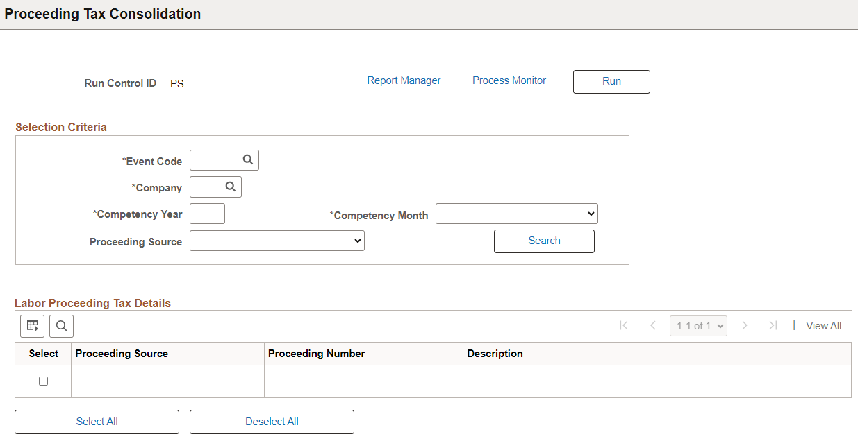

Use the Proceeding Tax Consolidation page to create S-2555 events or S-3500 events (which delete S-2555 events).

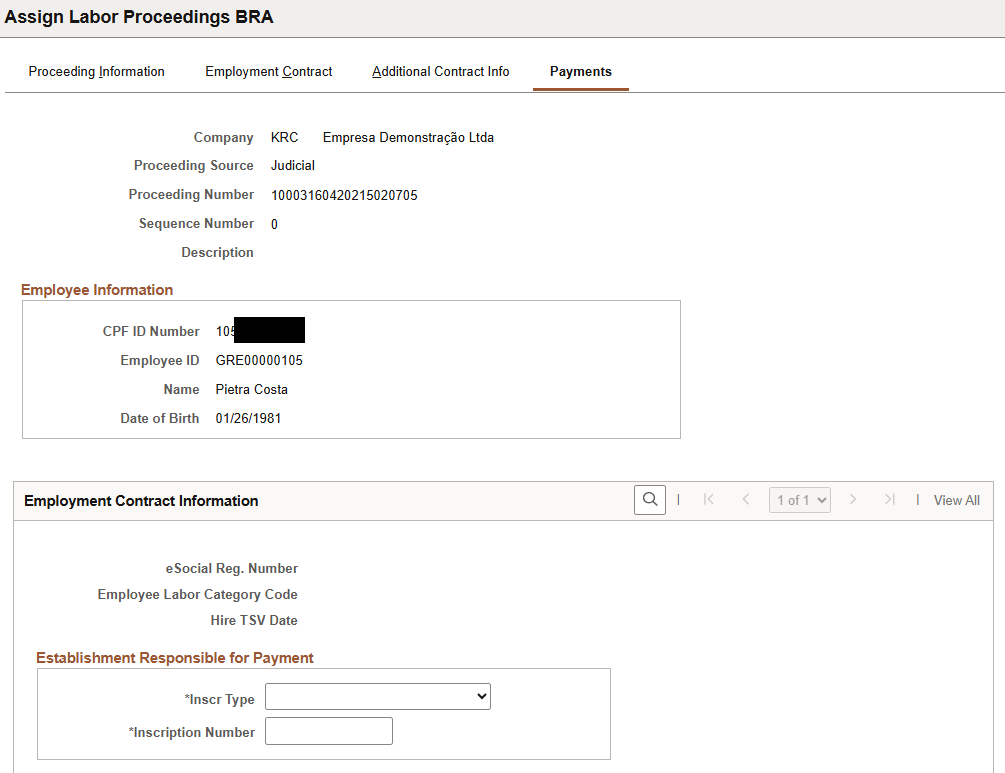

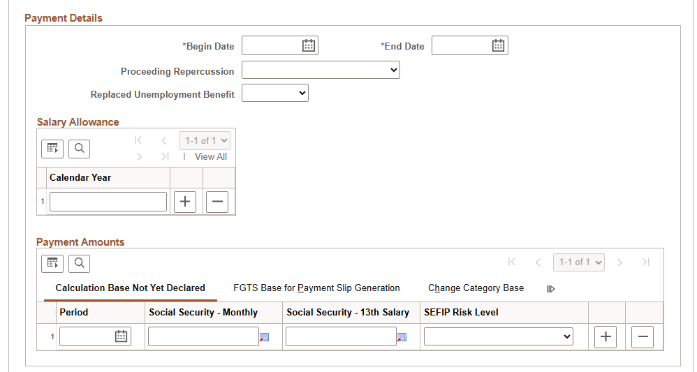

Payments Page
GPBR_LBR_PROC_PYMT

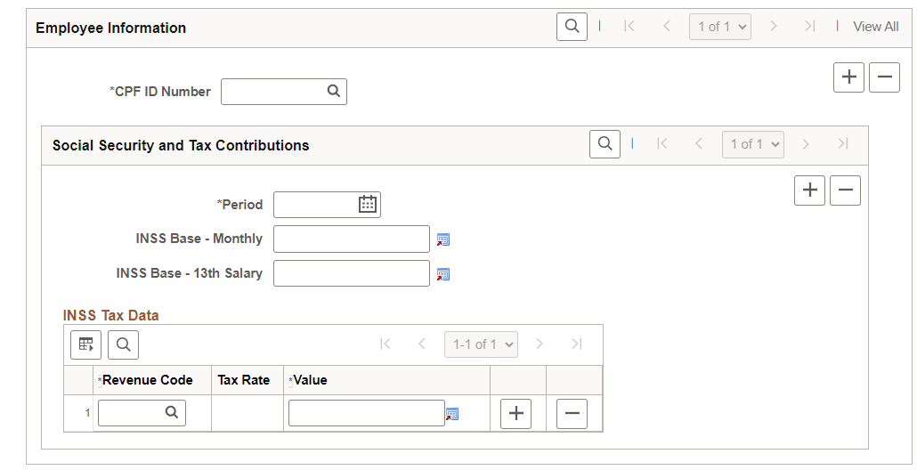

Enter detailed information about calculation bases of FGTS and INSS values.

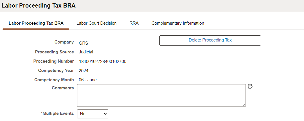

Labor Proceeding Tax BRA Page
GPBR_LABOR_PRC_TAX
Enter employee's IRRF and INSS tax information for a labor proceeding.

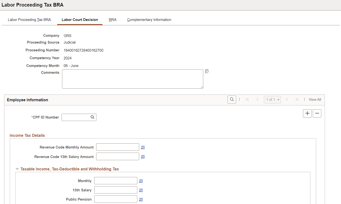

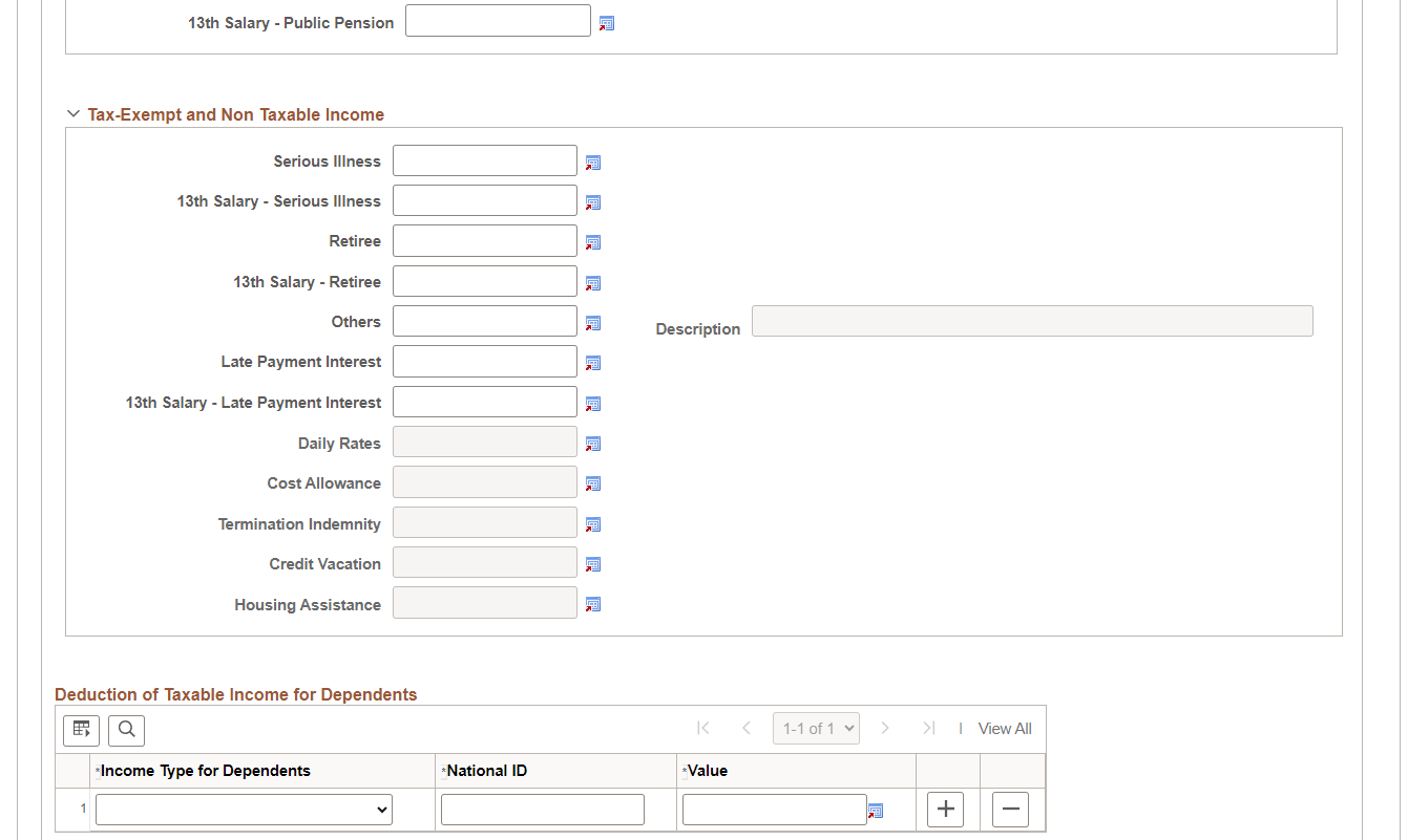

Labor Court Decision Page
GPBR_LPT_REV
Enter income tax and other information for a labor proceeding as decided from court.

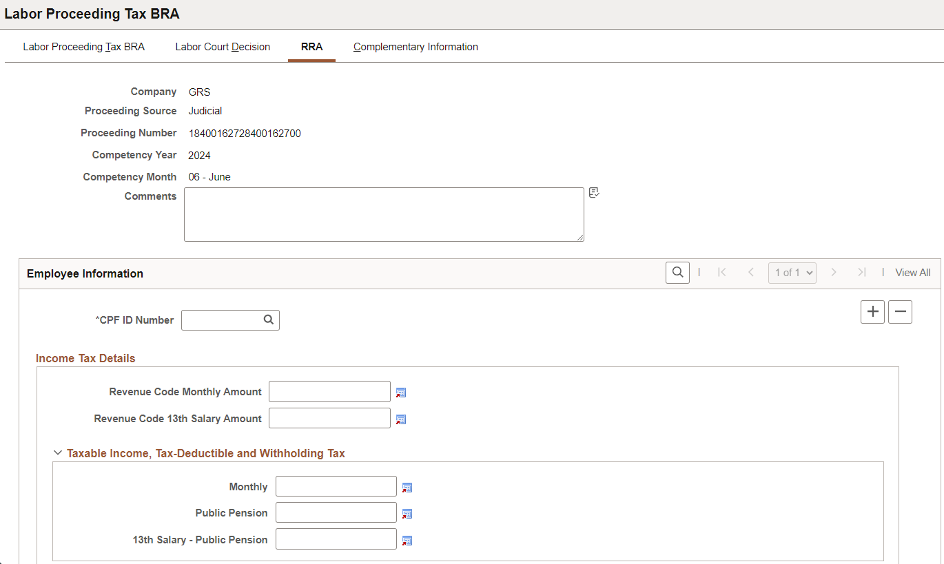

RRA Page
GPBR_LPT_REV_RRA
Enter accumulated income amounts received for previous years.

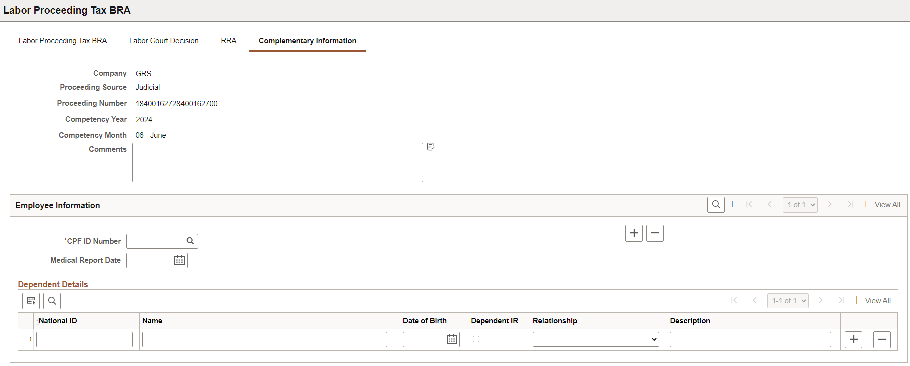

Complementary Information Page
GPBR_LPT_COMP_INFO
Enter employee's dependent information.

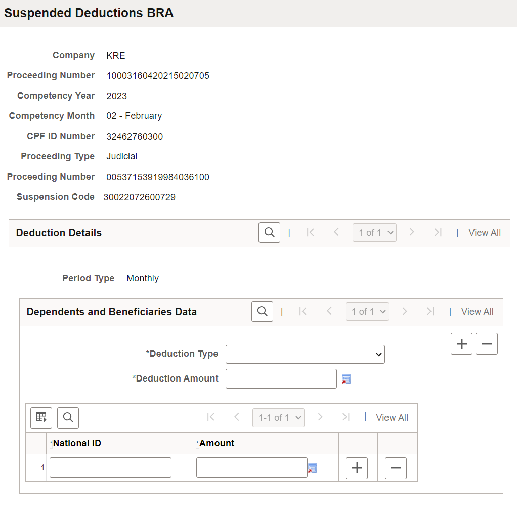

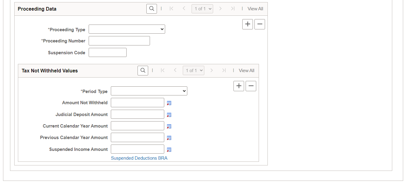

Suspended Deductions BRA Page
GPBR_LPT_SUSP_DED
Enter details for deductions with suspended liability.
Proceeding Tax Consolidation Page
GPBR_ES_LPTC_RC
Create or delete S-2555 events.

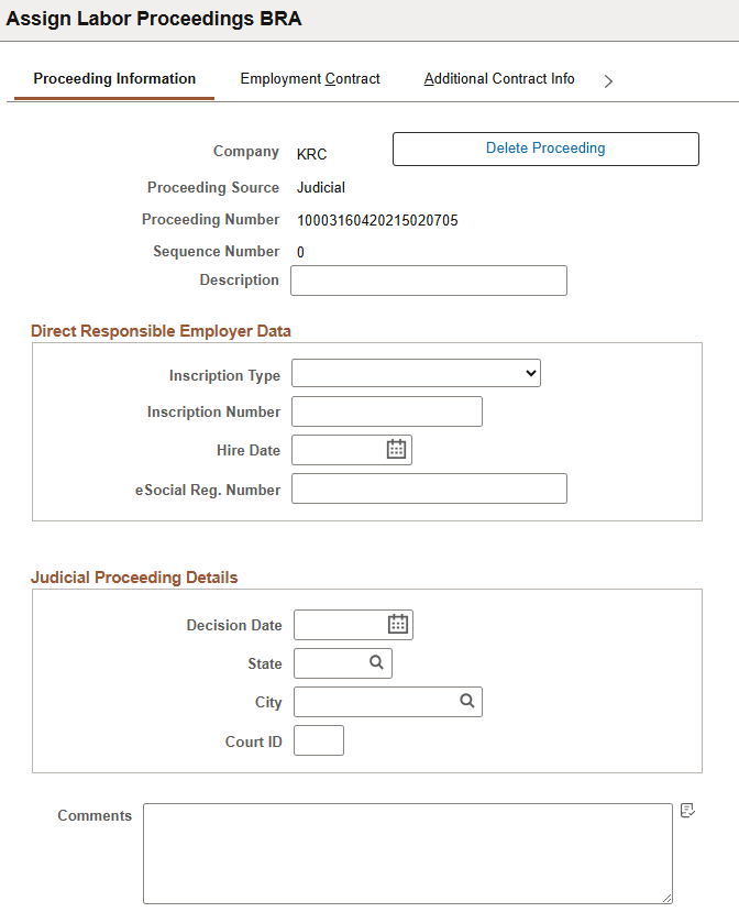

Use the Proceeding Information page (GPBR_LBR_PROC_HDR) to enter labor proceeding details.
Navigation:
Global Payroll & Absence Mgmt > Payee Data > Garnishments/Court Orders > Assign Labor Proceedings BRA > Proceeding Information
This example illustrates the fields and controls on the Proceeding Information page.
Field or Control
Description
Delete Proceeding
Select to remove the labor proceeding record from the system and the government (if applicable).
See Also S-3500 Exclusion Event - Labor Proceeding.
Company
Displays the company associated with the labor proceeding. This information is required when you add a labor proceeding in the system.
Proceeding Source
Displays the source of the labor proceeding:
Judicial
Submitted to CCP or NINTER
Proceeding Number
Displays the ID of the labor proceeding. This information is required when you add a labor proceeding in the system.
The length of the proceeding number is 20 digits if the selected source is Judicial.
The length of the proceeding number is 15 digits if the selected source is Submitted to CCP or NINTER.
Sequence Number
Displays the sequence number assigned to the labor proceeding by the company when it is necessary to send the same labor proceeding in multiple S-2500 events for the same CPF. If no sequence number was entered when the proceeding was created, 0 is displayed.
The maximum length of the sequence number is 3 digits.
Description
Displays or enter the description of the labor proceeding.
Direct Responsible Employer Data
Specify the company's HR and/or payroll representative (direct responsible).
Complete this section only if the company is mentioned in the proceeding as co-responsible.
Field or Control
Description
Inscription Type
Values are CNPJ and CPF.
Inscription Number
Enter the inscription ID of the company.
Hire Date
Enter the hire date of the selected representative.
eSocial Reg. Number
Enter the eSocial registration number date of the selected representative.
Judicial Proceeding Details
This section appears if the selected source is Judicial.
Field or Control
Description
Decision Date
Specify the date when the decision of this labor proceeding was made.
State, City, and Court ID
Specify the court location where this labor proceeding took place.
CCP/NINTER Proceeding Details
This section appears if the selected source is Submitted to CCP or NINTER.
Field or Control
Description
Date of Conciliation
Specify the conciliation date of the CCP or NINTER proceeding.
Ambit of Agreement
Select the information provider. Values are:
CCP Company
CCP Union
NINTER
Union CNPJ Number
Enter the registration number of the union that represented the worker. This is required if the Ambit of Agreement field value is CCP Company or CCP Union.

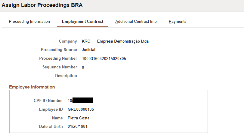

Use the Employment Contract page (GPBR_LBR_PROC_CNTR) to enter employee contract information of the labor proceeding.
Navigation:
Global Payroll & Absence Mgmt > Payee Data > Garnishments/Court Orders > Assign Labor Proceedings BRA > Employment Contract
This example illustrates the fields and controls on the Employment Contract page (1 of 2).
This example illustrates the fields and controls on the Employment Contract page (2 of 2).
Field or Control
Description
Company
Proceeding Source
Displays the source of the labor proceeding.
Proceeding Number
Displays the number of the labor proceeding.
Description
Employee Information
This section displays basic personal information of the worker to whom the labor proceeding pertains.
Field or Control
Description
CPF ID Number
Displays the claimant's national identification number. This information is required when you add a labor proceeding in the system. If a labor proceeding involves multiple claimants, each of them needs to be registered separately in the system.
Employee ID, Name and Date of Birth
The system prepopulates these fields automatically, if the entered CPF ID already exists.
Specify this information for the worker, if the entered CPF ID doesn't exist in the system.
Employment Contract Information
Use this section to enter the worker's contract data at the time of the labor proceeding resolution. Add new rows to capture the contract information in situations where multiple jobs are cited in the labor proceeding, or when the worker has multiple employee records (empl_rcd) even if they do not happen simultaneously.
Field or Control
Description
eSocial Reg. Number
Select (if CPF ID exists) or enter the worker's eSocial registration number.
Employee Labor Category Code
Select the worker's category code.
Hire TSV Date
(For non-employee) Select the worker's date of admission if the worker is a non-employee (the selected employee labor category code is 721, 722, or 901) and their eSocial registration number has not yet been sent to the Government using the S-2300 event.
The system does not validate this value.
Contract Type
Select the applicable contract type for the worker.
Original Hire Date
(For employee) Select the worker's date of admission if the worker is an employee (the selected employee labor category code is not 721, 722, or 901) and their eSocial registration number has not yet been sent to the Government using the S-2300 event.
Sent to eSocial
Indicate if the worker's admission information has been submitted to the Government using any of these events: S-2190, S-2200 or S-2300.
Reinstatement
Indicate if there was a request for the reinstatement of the worker in the labor proceeding.
Employee Category Changed
Indicate if there was a request to change the worker's labor category in the labor proceeding.
Nature of Activity Changed
Indicate if there was a request to change the nature of the worker's activity in the labor proceeding.
Reason for Termination Changed
Indicate if there was a request for a change in the worker's termination reason in the labor proceeding.

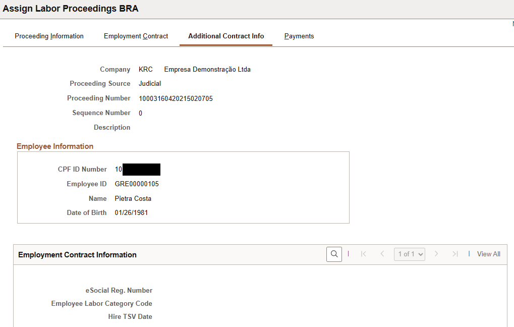

Use the Additional Contract Info page (GPBR_LBR_PROC_C_AD) to enter additional employment contract information of the labor proceeding.
Navigation:
Global Payroll & Absence Mgmt > Payee Data > Garnishments/Court Orders > Assign Labor Proceedings BRA > Additional Contract Info
This example illustrates the fields and controls on the Additional Contract Info page (1 of 4).
This example illustrates the fields and controls on the Additional Contract Info page (2 of 4).
This example illustrates the fields and controls on the Additional Contract Info page (3 of 4).
This example illustrates the fields and controls on the Additional Contract Info page (4 of 4).
Field or Control
Description
Company
Proceeding Source
Proceeding Number
Description
Field or Control
Description
CPF ID Number
Field or Control
Description
eSocial Reg. Number
Displays the worker's eSocial registration number if available.
Displays the worker's category code if available.
Hire TSV Date
Displays the worker's date of admission if available.

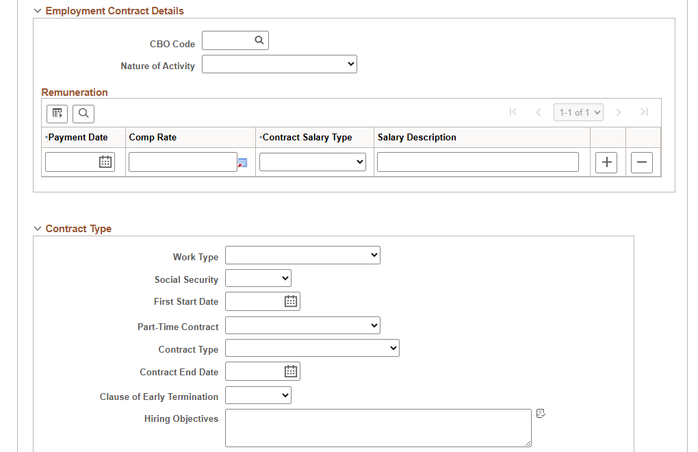

Employment Contract Details
Field or Control
Description
CBO Code
Specify the applicable Brazilian Occupation Classification code for the contract.
Nature of Activity
Select the nature of activity for the contract, Not Applicable, RURAL, or URBAN.
Remuneration
Use this section to record salary changes.
Field or Control
Description
Payment Date
Specify the salary change date.
Comp Rate
Enter the compensation rate.
Contract Salary Type
Select the applicable salary type, for example, monthly, by task, or commission-based.
Salary Description
Enter a short description about the salary if the selected salary type is by task or commission-based.
Contract Type
Complete this section only if the worker's admission information has not been submitted to the Government using any of these events: S-2190, S-2200 or S-2300.
Field or Control
Description
Work Type
Select the applicable labor regime type.
Social Security
Select the applicable social security system.
First Start Date
Select the worker's original hire date.
Part-Time Contract
Select the appropriate part-time nature of the contract.
Contract Type
Select the appropriate contract type for the worker.
Contract End Date
Select the end date of the contract for the worker.
Clause of Early Termination
Indicate if the contract has an assurance clause.
Hiring Objectives
Enter the objectives for hiring the position to which this contract pertains.

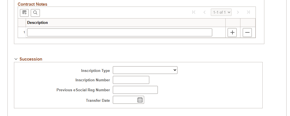

Contract Notes
Enter remarks about the contract, if applicable.
Succession
Complete this section if the worker transferred to this company from another company in the same socio-economic sector.
Field or Control
Description
Inscription Type and Inscription Number
Specify the inscription type and number of the company before the transfer.
Previous eSocial Reg Number
Enter the worker's eSocial registration number in the company before the transfer.
Transfer Date
Specify the date of transfer.

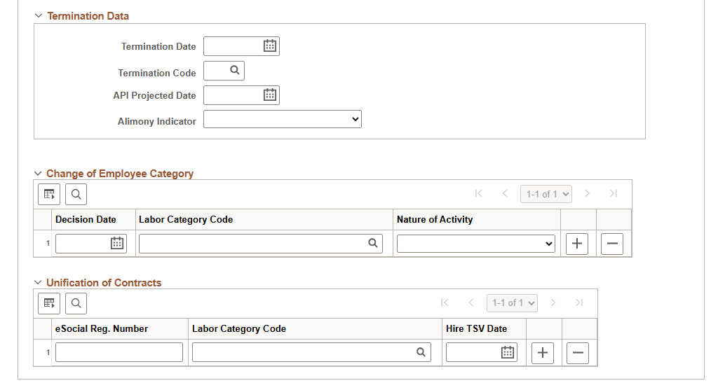

Termination Data
Enter the worker's termination information, if applicable.
Field or Control
Description
Termination Date
Specify the worker's termination date.
Termination Code
Select the reason code for the termination.
API Projected Date
Specify the projection date of the indemnified prior notice.
Alimony Indicator
Specify if the worker is responsible for alimony payment and payment type. The information is used for FGTS withholding purposes. Values are:
Amount
No Alimony
Percentage
Percentage and Amount
Deduction Amount
Specify the amount of the worker's alimony payment. This field appears if Amount or Percentage and Amount is selected.
% Deduction
Specify the percentage of the worker's pay that is allocated to alimony. This field appears if Percentage or Percentage and Amount is selected.
Change of Employee Category
If the worker had a change in the employee category,, enter the information in this section.
Field or Control
Description
Decision Date
Specify the date when the new labor category became effective.
Labor Category Code
Specify the new labor category.
Nature of Activity
Unification of Contracts
Field or Control
Description
eSocial Reg. Number
Enter the worker's eSocial registration number from the contract that needs to be unified with this contract.
Labor Category Code
Specify the worker's labor category code from the contract that needs to be unified with this contract.
Hire TSV Date

Use the Payments page (GPBR_LBR_PROC_PYMT) to enter detailed information about calculation bases of FGTS and INSS values.
Navigation:
Global Payroll & Absence Mgmt > Payee Data > Garnishments/Court Orders > Assign Labor Proceedings BRA > Payments
This example illustrates the fields and controls on the Payments page (1 of 2).
This example illustrates the fields and controls on the Payments page (2 of 2).
Field or Control
Description
Company
Proceeding Source
Proceeding Number
Description
Field or Control
Description
CPF ID Number
Field or Control
Description
eSocial Reg. Number
Hire TSV Date
Establishment Responsible for Payment
Field or Control
Description
Inscr Type (inscription type) and Inscription Number
Specify the inscription type and number of the establishment that is responsible for paying the indemnified amounts to the worker.
Payment Details
Field or Control
Description
Begin Date and End Date
Enter the start and end date of the labor proceeding.
Proceeding Repercussion
Specify the result or conclusion of the labor proceeding. Values are:
Exclusive for Income Statement
With Tax Impact and/or FGTS
Without Tax Impact or FGTS
Replaced Unemployment Benefit
Select if a decision was made to pay the unemployment insurance replacement compensation.
Salary Allowance
Field or Control
Description
Calendar Year
Specify the years in which there was a compensation that replaced the salary allowance, if applicable.
Salary allowance is an annual benefit that is paid to workers who satisfy certain criteria, for example:
  • Workers who earned on average up to two minimum wages of monthly compensation from employers contributing to the PIS or PASEP.
  • Worker who have worked for at least 30 days in the base year and have been registered for at least 5 years in the PIS/PASEP or CNIS.
Payment Amounts
Use this section to enter social security and FGTS calculation base amounts to be used for specified periods.
Calculation Base Not Yet Declared
Field or Control
Description
Period
Specify the date period the amount values became effective.
Social Security - Monthly
Specify the monthly social security calculation base amount.
Social Security - 13th Salary
Specify the 13th salary social security calculation base amount.
SEFIP Risk Level
Select the level of exposure to harmful agents for the period.
FGTS Base for Payment Slip Generation
Field or Control
Description
Labor Proceeding
Specify the FGTS calculation base amount that is not yet declared in SEFIP or eSocial, including the amounts recognized in the labor process.
Declared in SEFIP only
Specify the FGTS calculation base amount declared only in SEFIP but not in eSocial, and is not yet collected.
Declared before eSocial
Specify the FGTS calculation base amount declared in eSocial previously and is not yet collected.
Change Category Base
Field or Control
Description
Labor Category Code
Specify the worker's new employee labor category for the period, if applicable.
Declared Value in GFIP
Enter the amount, which is already declared in GFIP or the S-1200 event, to be considered for social security purposes.

Delete Proceeding Tax
Select to remove the labor proceeding tax record from the system and the government (if applicable).
Company, Proceeding Source, Proceeding Number, Competency Year and Competency Month
Displays the selected company, proceeding source, proceeding number, competency year and month when you add the labor proceeding tax record.
Comments
Enter any comment for this labor proceeding tax record, if applicable.
Multiple Events
Indicate whether or not to split the labor proceeding information into multiple files. Use this option only if it is not possible to send a single S-2501 event due to eSocial file size limit. The default value is No.
After you have selected Yes and saved the page, you cannot select No except when you delete this labor proceeding tax record using the Delete Proceeding Tax button.
Field or Control
Description
CPF ID Number
Select the CPF ID of the claimant. Only CPF IDs that are associated with the selected company and proceeding number are available for selection.
Social Security and Tax Contributions
Field or Control
Description
Period
Specify the date the amount values became effective.
INSS Base - Monthly and INSS Base - 13th Salary
Enter the monthly and 13th salary Social Security calculation base amounts for the specified period.
INSS Tax Data
Field or Control
Description
Revenue Code
Select the INSS revenue code for the labor processing tax.
Revenue codes are defined on the Revenue Code Page.
Tax Rate
Displays the tax rate of the specified revenue code.
Value
Enter the amount for the specified revenue code.
Use the Labor Court Decision page (GPBR_LPT_REV) to enter income tax and other information for a labor proceeding as decided from court.
Navigation:
Global Payroll & Absence Mgmt > Payee Data > Garnishments/Court Orders > Labor Proceeding Tax BRA > Labor Court Decision
This example illustrates the fields and controls on the Labor Court Decision page (1 of 3).
This example illustrates the fields and controls on the Labor Court Decision page (2 of 3).
This example illustrates the fields and controls on the Labor Court Decision page (3 of 3).
This page captures income tax information for:
  • The 593656 (IRRF - Labor Court Decision) revenue code if the selected proceeding source is Judicial, or
  • The 056152 (IRRF - CCP/NINTER) revenue code if the selected proceeding source is Submitted to CCP or NINTER,
as well as information on processes related to non-withholding of taxes or judicial deposits.
Field or Control
Description
Comments
Field or Control
Description
CPF ID Number
Income Tax Details
Field or Control
Description
Revenue Code Monthly Amount
Enter the monthly amount of the income tax.
Revenue Code 13th Salary Amount
Enter the 13th salary amount o the income tax.

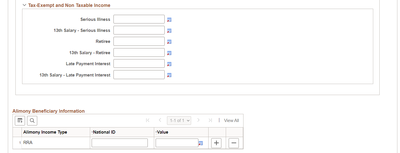

Tax-Exempt and Non Taxable Income
Field or Control
Description
Serious Illness
Enter the tax-exempt income for having a certified serious illness.
13th Salary - Serious Illness
Enter the 13th salary tax-exempt income for certified serious illness.
Retiree
Enter the tax-exempt portion of retirement benefits for beneficiaries aged 65 or higher.
13th Salary - Retiree
Enter the 13th salary tax-exempt portion of retirement benefits aged 65 or higher.
Others and Description
Enter any additional tax-exempt or non-taxable income, and its description.
Late Payment Interest
Enter the late payment interest received due to delay in payment of remuneration for carrying out a job, position or function.
13th Salary - Late Payment Interest
Enter the 13th salary late payment interest received due to delay in payment of remuneration for carrying out a job, position or function.
Daily Rates, Cost Allowance, Termination Indemnity, Credit Vacation, and Housing Assistance
Enter tax-exempt amounts for daily rates, cost allowance, termination indemnity, credit vacation, and housing assistance, if applicable. These fields are not editable if the selected proceeding source is Judicial.
Deduction of Taxable Income for Dependents
Field or Control
Description
Income Type for Dependents
Select the applicable income type for the dependent deduction. Values are:
13th Salary
Monthly Salary
National ID
Enter the CPF of the dependent.
Value
Enter the deduction amount from the calculation base for the specified income type and dependent.
Alimony Beneficiary Information
Field or Control
Description
Alimony Income Type
Select the applicable income type for the alimony deduction. Values are:
13th Salary
Monthly Salary
Nontaxable income
National ID
Enter the CPF of the alimony beneficiary.
Value
Enter the deduction amount from the calculation base for the specified income type and alimony beneficiary.
Proceeding Data
Field or Control
Description
Proceeding Type
Enter the government proceeding type. Values are:
Administrative
Judicial
Proceeding Number
Enter the proceeding number, or select the proceeding number if the option for proceedings parameters is enabled on the Adm/Legal Proceedings Parameters BRA Page.
Proceedings are defined on the Administrative/Legal Proceedings BRA Page.
Suspension Code
Enter the suspension code, or select the suspension code if the option for proceedings parameters is enabled on the Adm/Legal Proceedings Parameters BRA Page.
Tax Not Withheld Values
Field or Control
Description
Period Type
Select the calculation period. Values are:
Annual (13th Salary)
Monthly
Amount Not Withheld
Enter the withholding amount that is no longer made to the government due to the specified proceeding.
Judicial Deposit Amount
Enter the judicial deposit amount for the specified proceeding.
Current Calendar Year Amount
Enter the compensation amount received for the current calendar year due to the specified proceeding.
Previous Calendar Year Amount
Enter the compensation amount received for previous years due to the specified proceeding.
Suspended Income Amount
Enter the income amount with suspended liability.
Select to provide more details for the suspended deduction on the Suspended Deductions BRA Page.
Use the RRA page (GPBR_LPT_REV_RRA) to enter accumulated income amounts received for previous years.
Navigation:
Global Payroll & Absence Mgmt > Payee Data > Garnishments/Court Orders > Labor Proceeding Tax BRA > RRA
This example illustrates the fields and controls on the RRA page (1 of 3).
RRA page (1 of 3)
This example illustrates the fields and controls on the RRA page (2 of 3).
RRA page (2 of 3)
This example illustrates the fields and controls on the RRA page (3 of 3).
RRA page (3 of 3)
This page captures the accumulated income amounts that the employee received in the current year for previous years. Because these amounts pertain to previous years, they have different taxation treatment from the current taxation.
Field or Control
Description
Comments
Field or Control
Description
CPF ID Number
Income Tax Details
Field or Control
Description
Enter the monthly amount of the 188951 revenue code.
Enter the 13th salary amount of the 188951 revenue code.
Taxable Income, Tax-Deducitible and Withholding Tax
Field or Control
Description
Monthly
Enter the monthly taxable income for income tax.
Public Pension
Enter the monthly taxable income for official pension.
13th Salary - Public Pension
Enter the 13th salary taxable income for official pension.
Field or Control
Description
Serious Illness
Retiree
Field or Control
Description
Alimony Income Type
Displays the RRA type by default.
National ID
Value
Additional Information for RRA
Field or Control
Description
Description
Enter the description of the accumulated income received.
Months
Enter the number of months related to RRA.
Court Costs
Enter the total amount of expenses incurred for the use of the court, for example, court filing fees, photocopying costs, postage and so on.
Attorney Costs
Enter the total amount of attorney fees.
Attorneys
Field or Control
Description
Specify the inscription type and corresponding number of each attorney involved in the labor proceeding.
Value
Enter the amount of attorney fees paid to the attorney.
Use the Complementary Information page (GPBR_LPT_COMP_INFO) to enter employee's dependent information.
Navigation:
Global Payroll & Absence Mgmt > Payee Data > Garnishments/Court Orders > Labor Proceeding Tax BRA > Complementary Information
This example illustrates the fields and controls on the Complementary Information page.
Field or Control
Description
Comments
Field or Control
Description
CPF ID Number
Medical Report Date
Specify the date that the serious illness was reported.
Dependent Details
Field or Control
Description
National ID and Name
Enter the national ID and name of the dependent.
Date of Birth
Specify the birth date of the dependent.
Dependent IR
Select to indicate that the dependent is eligible for income tax deduction.
Relationship
Select the dependent's relationship to the employee.
Description
(Optional) Enter additional comment about the dependent's relationship to the employee.
Use the Suspended Deductions BRA page (GPBR_LPT_SUSP_DED) to enter details for deductions with suspended liability.
Navigation:
  • Select the Suspended Deductions BRA link on the Labor Court Decision Page.
  • Global Payroll & Absence Mgmt > Payee Data > Garnishments/Court Orders > Suspended Deductions BRA > Suspended Deductions BRA
This example illustrates the fields and controls on the Suspended Deductions BRA page (Labor Court Decision).
If the key information of the proceeding (such as the proceeding type, proceeding number, suspension code, or period type) is modified in the Proceeding Data section of the Labor Court Decision Page, the system deletes the associated suspended deduction information automatically. You need to reenter the information.
Field or Control
Description
Deduction Type
Select an applicable type for the deduction with suspended liability. Values are:
Alimony
Dependents
Public Pension
Deduction Amount
Enter the amount of deduction from the income tax calculation base with suspended liability.
National ID and Amount
Enter the CPF of the dependent or alimony beneficiary, and their deduction amount with suspended liability.
Use the Proceeding Tax Consolidation page (GPBR_ES_LPTC_RC) to create or delete S-2555 events.
Navigation:
Global Payroll & Absence Mgmt > Absence and Payroll Processing > Reports > eSocial BRA > Proceeding Tax Consolidation > Proceeding Tax Consolidation
This example illustrates the fields and controls on the Proceeding Tax Consolidation page.
Selection Criteria
Use this section to specify search criteria used to look up labor proceeding tax records.
Field or Control
Description
Event Code
(Required) Select:
S-2555 to generate S-2555 events for the selected labor proceeding tax records. Event S-2555 is used for calculating total tax amounts incurred from multiple S-2501 events for the same labor proceeding and assessment period.
S-3500 to delete S-2555 events for the selected labor proceeding tax records.
Company, Competency Year, and Competency Month
(Required) Specify a company, year, and month for the search.
Proceeding Source
Specify a proceeding source for the search, Judicial or Submitted to CCP or NINTER.
Labor Proceeding Tax Details
This section lists the search results. If the selected event is:
  • S-2555, matching labor proceeding tax records that have the Multiple Events field set to Yes on the Labor Proceeding Tax BRA Page are displayed for selection.
  • S-3500, matching labor proceeding tax records that were processed using S-2555 and returned from the government successfully are displayed for selection.
Select Run to launch the GPBR_ES_LPTC AE process to generate S-2555 events or S-3500 events for selected labor proceeding tax records.
