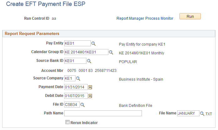

Use the Create EFT Payment File ESP (create electronic file transfer payment file) page (GPES_RC_BNK5) to create a flat output file to send to the bank.
This EFT payment file contains the payment details for each employee. It is sent to the bank so that funds can be transferred to employees' accounts. The file includes the employee name, beneficiary name, date, and amount of payment. At the end of this process, the system updates the GP_PAYMENT table by setting field PMT_STATUS from F (finalized) to T (transferred).

This example illustrates the fields and controls on the Create EFT Payment File ESP page. You can find definitions for the fields and controls later on this page.
Field or Control |
Description |
Pay Entity |
Enter the pay entity. |
Calendar Group ID |
Select the calendar group for the payroll run. |
Source Bank ID |
Displays the ID of the source bank from which the payments are withdrawn. |
Account Nbr |
Displays the bank account number for the source bank. |
Source Company |
A Calendar Group could have employees who belong to different companies. You can use this field to select the company that should be printed as the applicant / source of transfer. Note: System does not validate to check if the Source Bank Account belongs to the Source Company. |
Payment Date |
Enter the date of the bank file generation. |
Debit Date |
Enter the date on which the bank debits the transfers. |
File ID |
Select the ID of the banking file you want to use for the EFT file. You define banking files on the Define Bank File ESP page. |
Path Name |
Enter the directory to which you want the EFT file saved. |
File Name |
Enter a name for the EFT file. The system adds the company code and source bank ID to the name you specify and saves the file in text (.txt) format. |
Rerun Indicator |
Select to re-create the EFT file for payments that were already transferred. |
