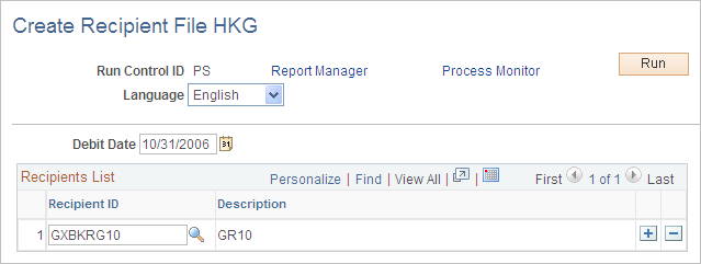

Use the Create Recipient File HKG page (GPHK_RCP_RUNCTL) to generate your recipient payment file.
This process stores recipient IDs that should be included during the EFT process for the recipient payment.

This example illustrates the fields and controls on the Create Recipient File HKG page. You can find definitions for the fields and controls later on this page.
Field or Control |
Description |
Debit Date |
Enter a date to initiate the process. The process retrieves all recipient payments for which the debit date in the GP_PAYMENT result table equals the debit date that you entered on the Create EFT Payment File HKG page. The system extracts payment data for which the deposit date equals the date that you enter here. |
Recipients List
Field or Control |
Description |
Recipient ID |
Enter one or more recipient IDs to restrict the number of recipients being processed and reported. |
Note: This page should contain the same values that you entered for the generation of the file for bank transfer. A different set of values can lead to generating a file with a totally different set of information. For example, if you ran the bank transfer with a payment date of March 31, 2007 and the recipient payment file is generated for February 28, 2007, the results are not the same. You should use the same run time parameters.
