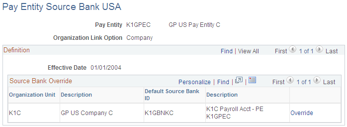

Use the Pay Entity Source Bank USA page (GPUS_PE_SBANK_OVRD) to select the pay entity for which you will override the source bank.
Navigation:
This example illustrates the fields and controls on the Pay Entity Source Bank USA page.
Field or Control |
Description |
Organization Unit |
Displays the organization unit that you defined on the Pay Entity - Source Bank Link page. |
Field or Control |
Description |
Default Source Bank ID |
Displays the source bank ID that you defined on the Pay Entity - Source Bank Link page. If your organization has multiple source banks, you can override the default source bank on the Source Bank Override USA page. |
Override |
Select the Override link to access the Source Bank Override USA page. |

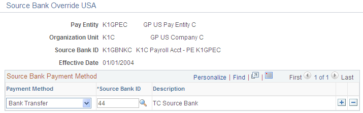

Use the Source Bank Override USA page (GPUS_PE_SBANK_SEC) to define the payment method and ID for the source bank override, if necessary.
Navigation:
Select the Override link on the Pay Entity Source Bank USA page.
This example illustrates the fields and controls on the Source Bank Override USA page.
The override option is used when multiple source banks are used.
Field or Control |
Description |
Payment Method |
Select the payment method to be used with the additional source bank. Options are Bank Transfer, Cash, Check, Postal Order, and Wire Transfer. Note: You cannot have two rows with the same payment method. |
Source Bank ID |
Select the ID for the additional source bank. |
