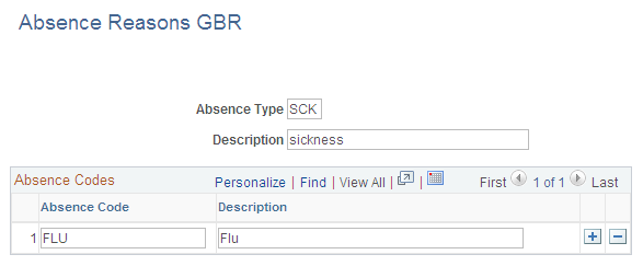

Use the Absence Reasons GBR page (GPGB_ABS_TYPE) to define an absence type and enter absence codes that further define the absence.
For example, if you have an employee who is absent from work due to sickness, record the type of sickness: flu, stomach bug, and so on.

This example illustrates the fields and controls on the Absence Reasons GBR page.

Absence Type |
Displays the name of the Absence Type that you enter. |

Absence Code |
Enter any Absence Code that further defines the Absence Type that you create. |
