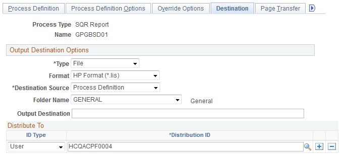

In addition to the output destination for the P45 process, you must set up the destination for the P45L report by updating the process definition.
See Destination Page.
Use the Destination page (PRCSDEFNCNTDIST) to define the output destination for the P45L SQR report (GPGBP45L).
Usually this is a one-time setup that you define during implementation.
Navigation:
This example illustrates the fields and controls on the Destination page.
Field or Control |
Description |
Output Destination |
Enter the path and filename. Enter an absolute path, such as c:\temp\p45.txt, or a relative path of the form: \\machinename\temp\p45.txt. |
