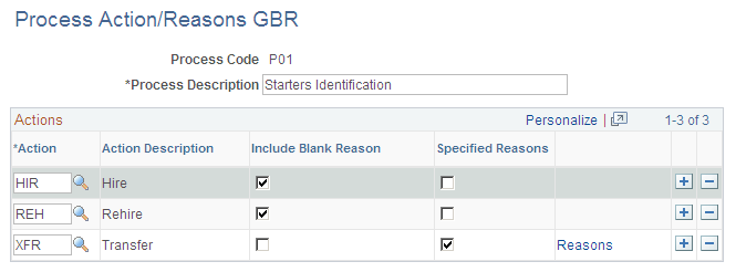

Process Action and Reason Page
In Global Payroll for the U.K, you may need certain processes to select employees who have rows in job data with particular action and reason codes. The Process Action/Reasons GBR page (Set Up HCM, Product Related, Global Payroll & Absence Mgmt, Framework, Processing, Process Action/Reasons GBR) enables you to define which of the Action and Reason codes available in job data apply to a specific payroll process. PeopleSoft delivers data for the P45 process and to identify starters (P01 starter identification) .

Use the Process Action/Reasons GBR page (GPGB_PRC_ACTRSN) to define the action codes that you want a process to search for in employees' job data.
Navigation:
This example illustrates the fields and controls on the Process Action/Reasons GBR page.
Warning! PeopleSoft delivers system data for this page. You can add reasons and new actions, but you must not remove any of the delivered action codes. The P45 processes and the starter identification will not work correctly if the required data is removed.
Field or Control |
Description |
Process Code |
Displays the code for the process: P45: To set up the action codes for the P45 process. P01: To set up the action codes for identifying new starters. |
Action |
Select the action code that you want the process to search for in job data. Action codes are defined in HR tables. |
Include Blank Reason |
Select this check box if you want the process to select employees with the action code specified and no reason code selected. If you deselect this check box, the process excludes employees who have no reason code (a blank field). |
Specified Reasons |
Select this check box if you want the process to select employees with specific reasons in their job data. Use the Reasons page to define a set of reasons. The process only selects employees whose job data have matching reason codes. If you deselect this check box, the process returns employees whose job data includes the specified action code and any reason code. |
Reasons |
Click this link to access the Reasons page where you select the reasons that the process searches for in employees' job data. You must complete the Reasons page if you select the Specified Reasons check box. |
