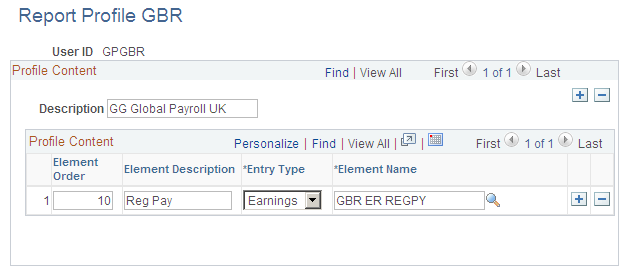

Use the Report Profile GBR page (GPGB_PROFILE_PNL) to create a profile for a user.
This profile is then used in the Profile Report, which displays exactly the information that you specified.
Navigation:
This example illustrates the fields and controls on the Report Profile GBR page.
Field or Control |
Description |
Element Order |
Enter the order in which you want the elements to appear in the Profile Report. |
Entry Type |
Select the type of element that you want to display on the Profile Report. |
Element Name |
Select the element that you want to appear on the Profile Report. The elements that are available are those belonging to the entry type that you select. |
