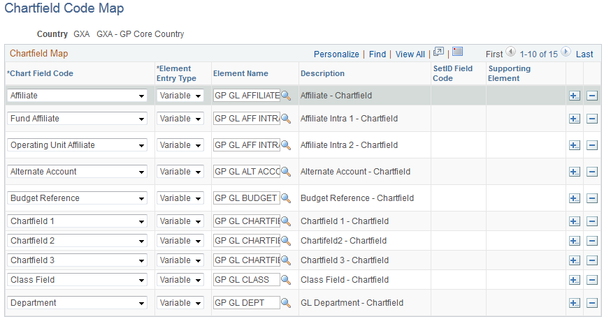

Use the Chartfield Code Map page (GP_CHART_ELEM) to map standard GL chartfields that are defined in payroll to chartfield variables that are defined in Global Payroll.
Navigation:
This example illustrates the fields and controls on the Chartfield Code Map page.
Global Payroll delivers variables to represent each of the chartfields:
GP GL PRODUCT
GP GL PROJECT
GP GL DEPT
GP GL FUND
GP GL PROGRAM
GP GL CLASS
GP GL AFFILIATE
GP GL ALT_ACCOUNT
GP GL BUDGET_REF
GP GL CHARTFIELD1
GP GL CHARTFIELD2
GP GL CHARTFIELD3
GP GL AFF_INTRA1
GP GL AFF_INTRA2
GP GLBU PC
GP GL ACTIVITY
GP GL SOURCE TYPE
GP GL CATEGORY
GP GL SUBCATEGORY
This page enables you to map the PeopleSoft standard configuration chartfields to these delivered chartfield variables. This mapping enables Global Payroll to receive chartfield information for payable time. You can create a separate mapping scheme for each country in which your organization operates.
Note: The system can send a maximum of 21 mapped chartfields to PeopleSoft General Ledger. Therefore, we recommend that you add no more than 21 chartfields to each mapping scheme.
Field or Control |
Description |
Chartfield Code |
Enter the GL chartfield to map to a variable. |
Element Entry Type |
Select the type of element to which the chartfield is mapped. Values are: Variable: User-created variable. For example, you may decide to rename GP GL CHARTFIELD1 so that the name matches the information contained in the field. SystemElem (system element): PeopleSoft standard configuration chartfields. |
Element Name |
Select the name of the variable to which you are mapping the chartfield. |
SetID Field Code and Supporting Element |
Displays the set ID fields associated with the variable or system element. |

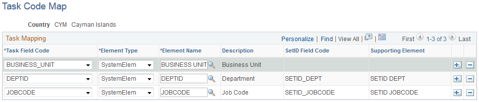

Use the Task Code Map page (GP_TL_TASK_ELEM) to map task codes that are defined in Time and Labor to supporting elements that are defined in Global Payroll.
Navigation:
This example illustrates the fields and controls on the Task Code Map page.
Tasks define companies, business units, products, departments, and other entities to which payees can report time.
If you don't map task entities, Global Payroll calculates costs at the earning and deduction level only and cannot supply Time and Labor with a cost breakdown by task. You can create a separate mapping scheme for each country in which your organization operates.
Task Mapping
Insert a row for each Time and Labor element that you want to load into Global Payroll. During the bundling process, Global Payroll consolidates instances of payable time that share the same values for the entities that you select. For example, if you select BUS_UNIT in the Task Field Code field, instances of payable time that share the same business unit are bundled at the start of the pay run.
Field or Control |
Description |
Task Field Code |
Select the Time and Labor entity to map to a supporting element. Values are: BUS_UNIT (business unit), COMBO_CD (combination code), COMPANY, COUNTRY, DEPTID (department ID), JOBCODE, LOCATION, PRODUCT, RATE_VAL (rate value), STATE, TASK, and USERFIELD1 to 5. |
Element Type |
Select the type of element to which the task code is mapped. Values are: Variable and SystemElem (system element). |
Element Name |
If you selected DEPTID, LOCATION, or JOBCODE as the task field code and SystemElem as the element type, the name of the element that retrieves the value of the task entity appears in this field. Otherwise, select the name of the element that you are mapping the task to. You can select from system or variable elements only, depending on the value in the Element Type field. |
If you selected DEPTID, LOCATION, or JOBCODE as the task field code and SystemElem as the element type, the system displays the SetID field code that is associated with the element and the name of the system element that's associated with the SetID field code, respectively. |
