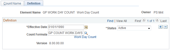

Use the Counts - Definition page (GP_COUNT) to define a count element.
Use this page to select an existing counting formula.
Navigation:
This example illustrates the fields and controls on the Counts - Definition page.

Count Formula |
Enter the name of the formula that performs the count. |

<Formula Name> link |
Click the link next to the Count Formula field to access the formula definition pages. |
