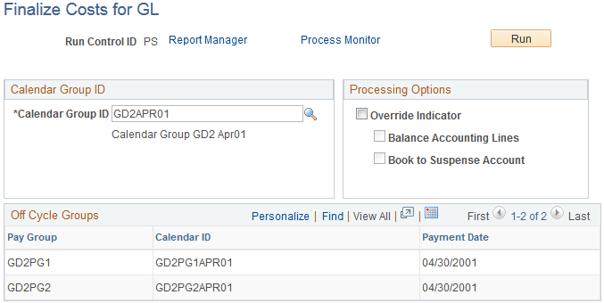

Use the Finalize Costs for GL page (HPIP_GP_FINALIZE) to prepare the accounting lines for posting and post them to General Ledger.
Navigation:
This example illustrates the fields and controls on the Finalize Costs for GL page.
Field or Control |
Description |
Override Indicator |
Select to override the default balance options set for the target product on the Configure Target System page. The other fields in this group box are available for entry only if Override Indicator is selected. |
Balance Accounting Lines |
Select this check box if you want the system to calculate whether the debits equal the credits for each general ledger business unit. |
Book to Suspense Account |
This field is available for entry if you select Balance Accounting Lines. Select Book to Suspense Account to post unbalanced amounts to a suspense account when the credits do not equal debits. If selected, you must specify a suspense account number on the Configure GL Business Unit page. |

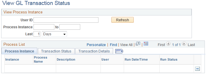

Use the View GL Transaction Status page (HPIP_PRCS_STAT) to view the transaction status of the posting process.
Navigation:
This example illustrates the fields and controls on the View GL Transaction Status page.
Note: As you continue to post accounting lines, the Transaction Status tables can grow significantly, since each posting process writes data to these tables. These tables are not automatically purged. To purge data from these tables, you can click the Delete button to delete one or more rows. After you delete a row on this page, the data displayed in the Process Parameters, Detail Transactions, and Accounting Line Data pages is also purged when you save the View GL Transaction Status page.
View Process Instance
Use the fields in this group box to select the process instances to view. The page automatically displays the process instances from the last day.
Field or Control |
Description |
User ID |
Enter a user ID to view only process instances associated with that ID. |
Process Instance |
If you know the process instance numbers for the process instances you want to view, enter the numbers. |
Last |
Enter a quantity and then select the associated duration (days, hours, or minutes). If you want to see all results, select None. |
Refresh |
After you have entered criteria, click this button to refresh the information that appears Process List group box. |
Process Instance Tab
The fields on this tab display the same information as the Process Monitor.

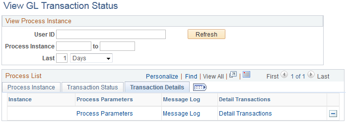

Transaction Details Tab
Select the Transaction Details tab.
This example illustrates the fields and controls on the View GL Transaction Status page: Transaction Details tab.
Each posting that exceeds the maximum number of accounting lines, as specified for the target product, is separated into multiple segments. Each segment is sent as an individual message by the Integration Broker. Use this page to view the status and information related to the individual segments.
Field or Control |
Description |
Process Parameters |
Click to access the View Process Parameters page. |
Message Log |
Click to access the Process Message Log page. |
Detail Transactions |
Click to access the View Detail Transactions page. |

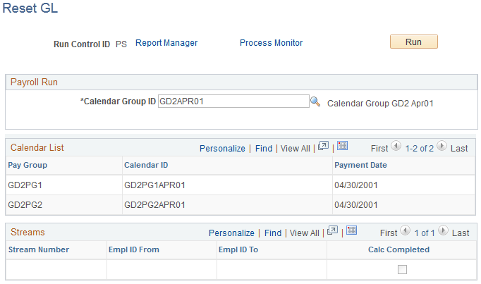

Use the Reset GL page (GP_GL_RESET) to run the GL Reset process before rerunning the GL Transaction Creation process when reposting is necessary due to errors.
Navigation:
This example illustrates the fields and controls on the Reset GL page .
Note: Use this process only if it is necessary to repost the transactions because they were originally sent with errors. After resetting, correct the data errors and repeat GL processing.
Field or Control |
Description |
Calendar Group ID |
Select the calendar group for which you want to reset the GP GL interface processing. Resetting applies to the entire calendar group. |
The remaining fields on the page are for information only; you cannot enter or alter the data.
