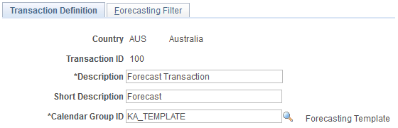

Use the Transaction Definition page (GP_TXN) to create a transaction definition by linking a calendar group template to the Absence Forecasting process or Balance Inquiry process.
A transaction definition is linked to a specific country.
Navigation:
This example illustrates the fields and controls on the Transaction Definition page.
Field or Control |
Description |
Transaction ID |
Values are: 100: Absence Forecasting process. 110: Balance Inquiry process. Note: You can define one of each type of transaction ID per country. |
Calendar Group ID |
Select the appropriate calendar group ID. You can choose from the list of calendar group IDs that have been set up as templates. |

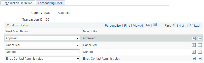

Use the Forecasting Filter page (GP_TXN_FILTER) to select the status of the absence events that the system is to consider when you run the Forecasting process.
If integrating with Time and Labor, the status selected will be considered with forecasting processes on Timesheets also.
Navigation:
This example illustrates the fields and controls on the Forecasting Filter page.
The system uses status values, such as Saved, Submitted, and Approved, to track and manage the approval of absence requests.
If you are using absence self service, use this page to specify which absence statuses the system is to consider when using forecasting. For example, you may want the forecasting process to evaluate only those absences that have a status of Approved. In this case, you would select Approved in the Workflow Status field.
Note: If integrating with Time and Labor, use this page to specify which absence statuses the system is to consider when using forecasting on Timesheets.
When an absence is requested through the Absence Event Entry page the Workflow Status field is set to blank. If you run the absence forecasting, such events will be considered during forecasting. If you have events entered through event entry and self service, when you run forecasting it will consider all the events entered through event entry plus those entered through self service and whose statuses were included in the Forecasting Filter page.
