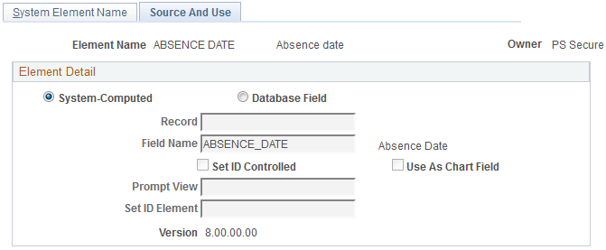

Use the Source And Use page (GP_SYSTEM_PIN) to displays whether a system element is a system-computed element or a database system element.
For a database system element, it also displays the record and field that populates it and indicates whether the field is SetID-controlled.
Navigation:
This example illustrates the fields and controls on the Source And Use page.
Field or Control |
Description |
Record |
Displays the record from which the system element obtains its information. |
Field Name |
Displays the field from which the system element obtains its information. |
SetID Controlled |
Selected if the field is controlled by SetID. Elements that are controlled by SetID have field name and prompt view values. |
Use As Chart Field |
For database fields, you can select this check box to use the element as a ChartField. ChartFields are applicable when you integrate Global Payroll with PeopleSoft General Ledger. |
Prompt View |
Elements that are controlled by SetID or used as ChartFields have a prompt view specified. If a SetID controlled system element is used as a supporting element override for positive input, it also requires a prompt view. |
SetID Element |
Displays the SetID field name for the system element. |
