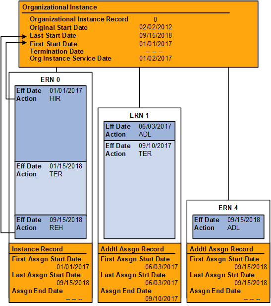

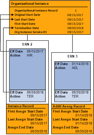

Finally, the division in which Bobby has worked the two jobs in his second organizational instance closes, terminating both the controlling instance and, by association, the assignment effective September 30, 2018 and Bobby is rehired into his original job with a new, additional job on the side, effective September 15, 2018.
The following graphic illustrates Bobby's organizational instance record 0 and assignments:
The following graphic illustrates Bobby's organizational instance record 1 and assignments:
Notice that all of the instance dates come from the controlling assignment and that the termination date is refreshed when Bobby is rehired.
