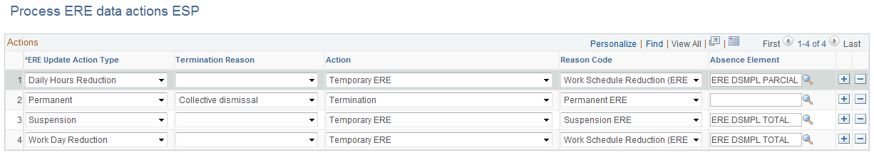

Use the Process ERE data actions ESP page (ERE_UDTA_ACTN_ESP) to define ERE data actions.
Navigation:
This example illustrates the fields and controls on the Process ERE data actions ESP page. You can find definitions for the fields and controls later on this page.
Use this page to determine how the system updates job and payroll data for employees for each of the different types of ERE actions.
| Field or Control | Description |
| ERE Update Action Type | Select the ERE update action type you are defining. Valid values are: Daily Hours Reduction, Permanent, Suspension, and Work Day Reduction. |
| Termination Reason | Select the termination reason that the system uses when updating the Manage Terminations ESP page when you run the Process ERE Data (ERE_UDTA_ESP) process. Typically you select a value in this field only for the Permanent ERE update action type. |
| Action | Select the action that the system uses when updating the Work Location page of the Job Data component when you run the Process ERE Data (ERE_UDTA_ESP) process. |
| Reason Code | Select the reason that the system uses when updating the Work Location page when you run the Process ERE Data (ERE_UDTA_ESP) process. |
| Absence Element | Enter the absence take element that the system uses to update the Absence Event Entry page when you run the Process ERE Data (ERE_UDTA_ESP) process. Oracle delivers the following ERE absence takes:

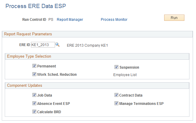

Use the Process ERE Data ESP page (ERE_RC_UPD_DTA_ESP) to process ERE data.
Navigation:
This example illustrates the fields and controls on the Process ERE Data ESP page. You can find definitions for the fields and controls later on this page.
Use this page to run the Process ERE Data (ERE_UDTA_ESP) process.
| ERE ID | Select the ERE event for which you want to run the process. |
Employee Type Selection
Select the types of ERE for which you are running the process.
| Permanent | Select to update the job and payroll data for employees affected by permanent ERE. |
| Suspension | Select to update the job and payroll data for employees affected by suspension ERE. |
| Work Sched. Reduction (work schedule reduction) | Select to update the job and payroll data for employees affected by work schedule reduction ERE. |
Component Updates
Select the components you want the process to update for employees affected by ERE.
| Job Data | Select to update the Work Location page. |
| Contract Data | Select to update the Contract Status/Content page. |
| Absence Event ESP | Select to update the Absence Event Entry page. |
| Manage Terminations ESP | Select to update the Manage Terminations ESP page. |
| Calculate BRD | Select to update the following fields on the Permanent ERE Employee Data, Suspension ERE Employee Data, and Work Reduction Employee Data pages:
