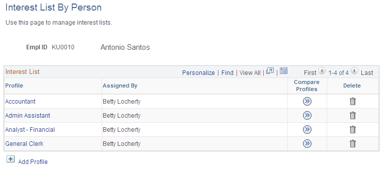

Use the Interest List by Person page (JPM_INTEREST_PERS) to view an employee's interest list and add profiles to the list.
Navigation:
This example illustrates the fields and controls on the Interest List by Person page. You can find definitions for the fields and controls later on this page.
Field or Control |
Description |
Add Profile |
Click this link to add another profile to the employee's interest list. |
Compare Profiles |
Click this icon to access the Compare Results page. In order to use the compare process, you must first build the appropriate search indexes. See. Building the Search Indexes. |

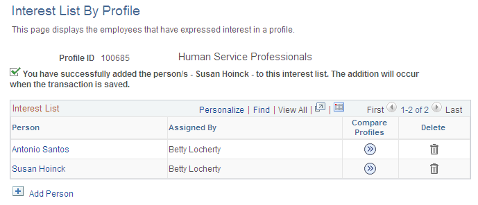

Use the Interest List by Profile page (JPM_INTEREST_PROF) to view a list of employees who have a selected profile on their interest list.
You can also add the selected profile to an employee's interest list.
Navigation:
This example illustrates the fields and controls on the Interest List by Profile page. You can find definitions for the fields and controls later on this page.
Field or Control |
Description |
Add Person |
Click this link to add the profile to another employee's interest list. |
Compare Profiles |
