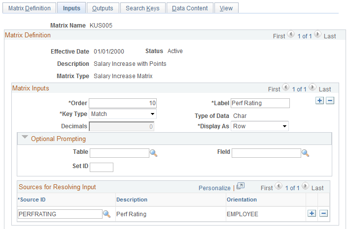

Use the Inputs page (WCS_LK_TBL_INPUTS) to define inputs to the configurable matrix.
Navigation:
This example illustrates the fields and controls on the Inputs page.
Matrix Inputs
Field or Control |
Description |
Order |
Enter the numerical value to indicate the order in which the inputs should appear in the configurable matrix. This value will also determine the order in which the inputs are evaluated against the worker data. |
Label |
Enter the label that will appear. |
Key Type |
Select a value:
Decimals |
Enter the number of decimal positions to maintain for numeric inputs. This field will be grayed out as applicable. |
Display As |
Select whether this input should appear as a Row or a Column header. Important! Only one input can be selected as a column header. However, you can choose to have all inputs appear as rows. |
Optional Prompting
If you want the ability to enter search keys from a prompt table, you can use this section to specify the table, the field, and, if appropriate, the setID.
Note: The system does not enforce that search keys must exist in that table. You are allowed to enter search keys that are new and do not exist in any table.
Sources for Resolving Input
Field or Control |
Description |
Source ID |
Select one or more sources that can be used to derive the matrix inputs. For example, if you are defining an input for JOBCODE, you should select the JOBCODE source ID. Every input is defined using at least one source; therefore, you must select at least one source. Note: You can leave the label for the input blank, and upon selecting the source, the system will populate the label field with the default label for that source. |

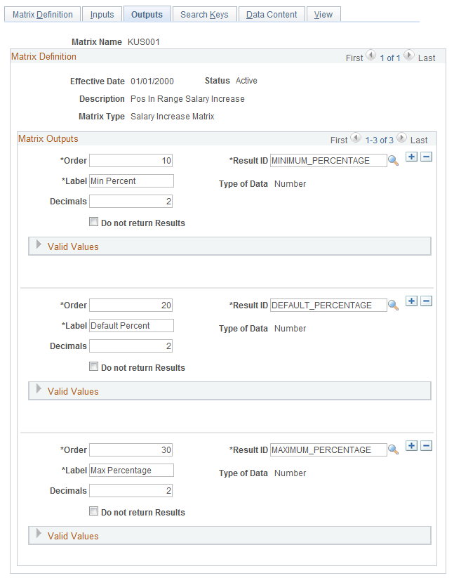

Use the Outputs page (WCS_LK_TBL_OUTPUTS) to define outputs of the matrix.
Navigation:
This example illustrates the fields and controls on the Outputs page.
Note: Results that are available on this page will differ depending upon the matrix type.
Matrix Outputs (Result Columns)
Field or Control |
Description |
Order |
Enter a numerical value that indicates the order in which the outputs should appear in the matrix. |
Result ID |
Select a value that the configurable matrix should return as an output. These values come from the Results ID table. |
Label |
Enter the label that will appear in the matrix. |
Type of Data |
This display-only field indicates if the result ID has a character, number, or date format. |
Decimals |
If the result ID has a number format, then you can enter the number of decimal places that you want to appear in the matrix. |
Do not return Results |
Select this check box if the result is to be used as a reference only for a calculation in another result. For example, if you have a PCNTOFBASE type result that uses BASERATE as its reference, then you can set this check box on the BASERATE result ID. The calling program will only receive PCNTOFBASE as an output result ID; it will not receive any other output from the matrix. Note: You will see all defined result IDs on matrix displays, even though this check box may be selected for some results. |
Valid Values |
Select a table, a field, and, if appropriate, a setID to use to designate a list of values for an output column. The system uses the record and field designations as an edit table for the output values. |

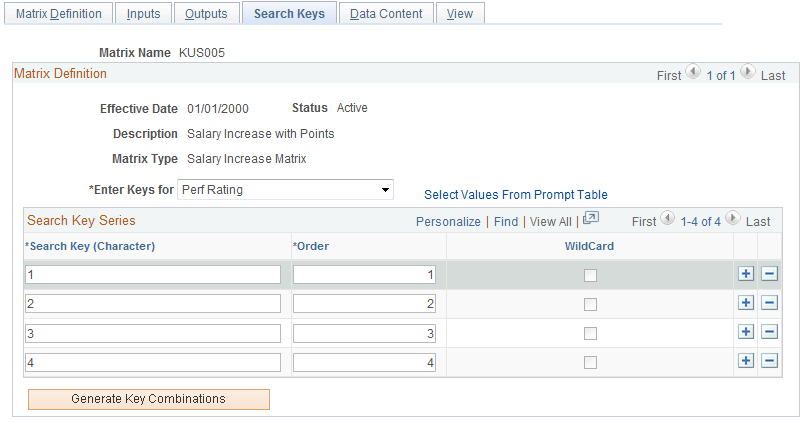

Use the Search Keys page (WCS_LK_TBL_KEYS) to specify the search keys to be used to match worker data.
Navigation:
This example illustrates the fields and controls on the Search Keys page.
Use this page to enter the key values against which worker data is matched. In the previous example, the system checked for worker's performance ratings to be 1, 2, 3, or 4.
Note: For market pay matrices, you are allowed to create the matrix without specifying any search keys and output data values, which is useful when you intend to load data into the matrix from a flat file. In this case, you define the matrix, but you do not specify search keys and output data. You can still update the status to Active. Then, you can load data into it from a flat file. However, if you change the status of the matrix to Active and you have not defined any search criteria or values, you will receive a warning.
For more options, review the sections about market pay matrices for an explanation of how to load data into a matrix.

Search Key Series
Field or Control |
Description |
Search Key (Character) |
Enter a value, which will be the key value against which worker data is matched. For example, you would enter rows with key values 1, 2, 3, 4 for the input Performance Rating. You would enter key values 40, 60, 80, and 100 for the input Percent-in-Range. |
Order |
Enter a numeric value that indicates the order in which the search keys will appear in the matrix. This field only applies to keys of type Character. Numeric and Date values have an implicit order and do not use this field for display order. |
WildCard |
Select if the system should use the search key as a wildcard. That is, if the worker's data did not match any other key, then the system will use this row as a match. For example, assume that four departments are listed in the matrix as keys 101, 102, 103, and 104. If you wanted all workers in all other departments to be handled separately, then you would enter a fifth key for Dept and make it a wildcard. You can set a wildcard only if the key type is set to Match. Wildcards do not apply for key type of Range. |
Generate Key Combinations |
After you have completed entering keys for all inputs, click this button to generate the key combinations for the configurable matrix. The system automatically takes you to the Data Content page, where you can enter values for each result ID for different input combinations. |

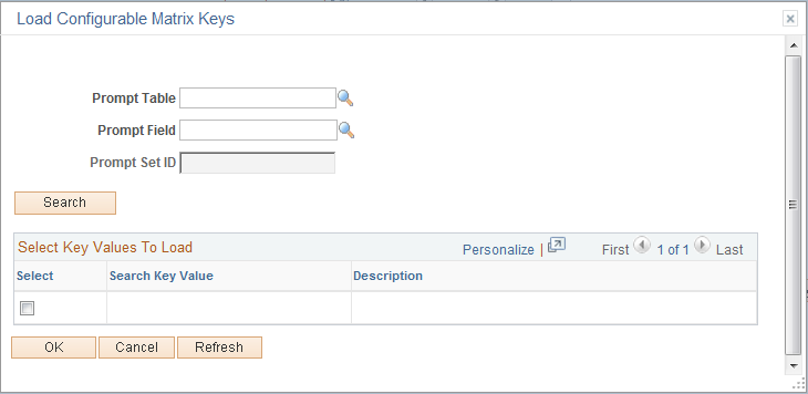

Use the Load Configurable Matrix Keys page (WCS_LK_TBL_KEY_SEC) to automatically load search keys for specific sources using a prompt table.
Navigation:
Click the Select Values from Prompt Table link on the Search Keys page.
This example illustrates the fields and controls on the Load Configurable Matrix Keys page.
To load values from a specific prompt table:
Select a value in the Prompt Table field.
Select a value in the Prompt Field field.
Click the Search button.
In the Select Key Values To Load grid, select the check boxes for the values you want to load.
Click OK.

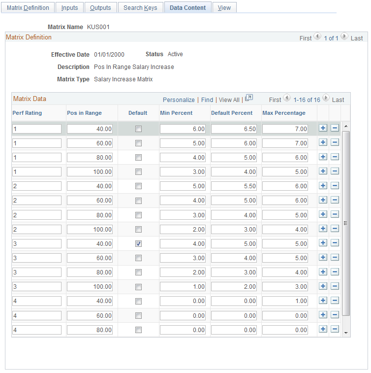

Use the Data Content page (WCS_LK_TBL_DATA) to enter values for the output data.
Navigation:
This example illustrates the fields and controls on the Data Content page.
This page lists the combinations of search keys for all inputs that the matrix will evaluate. For each combination, it lists all outputs fields. You can add the character, date, or numerical values of each output here. The columns that appear on this page vary depending on the fields you define on the Inputs page and Outputs page. The columns to the left of the Default check box are defined on the Inputs page. The columns to the right of the Default check box are defined on the Outputs page.
Note: All inputs appear to the left of the Default column, and all outputs appear to the right of the Default column.
Field or Control |
Description |
Default |
(Optional) Select the row that you want to use as default results if the system does not find a match between the worker data and any combination of input rows. In the previous example, you were able to choose a default for a worker who was above or below the 40 and 100 ranges or who did not have a performance rating. A good practice is to select a default for a rate matrix that is attached to a rate code that is associated with a salary step. Important! You can only select one row as a Default. |
