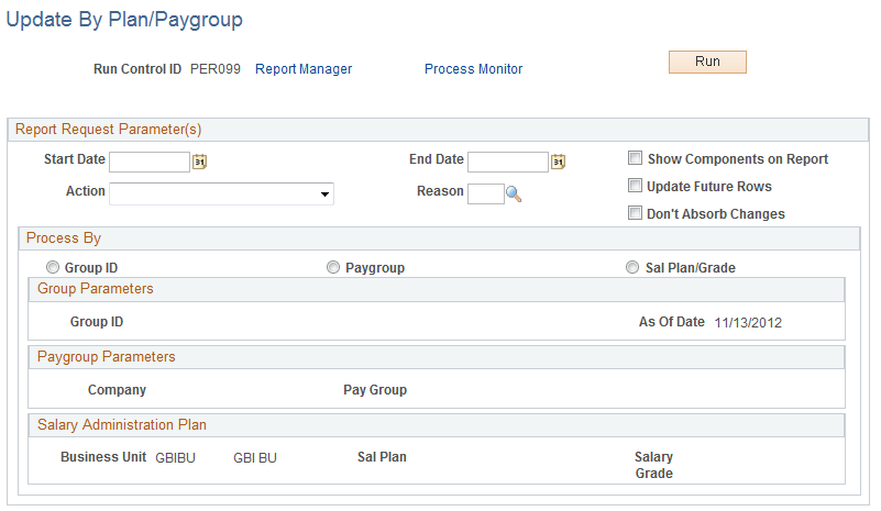

Use the Update By Plan/Paygroup page (RUNCTL_CMP008) to update the job compensation rate when the salary grade or step changes retroactively.
Navigation:
This example illustrates the fields and controls on the Update By Plan/Paygroup page.
Report Request Parameter(s)
Field or Control |
Description |
Start Date and End Date |
Enter the start and end dates of the period. The system retrieves the salary change between these dates. |
Show Components on Report |
Select if you want the pay components to appear on the report. |
Action and Reason |
Enter the action and reason defining the salary update on the new job row. |
Update Future Rows |
Select to have the process update future dated rows (those rows with an effective date later than the Salary Change Effective Date) with salary information. |
Don't Absorb Changes |
Select to instruct the system to leave absorbable rate codes unchanged if the system provides the salary amount by default. This option only applies to workers who have a Target Comprate and are assigned to a salary plan with the Auto Calculated Premium function enabled. |
Process By
Field or Control |
Description |
Group ID |
Select to process by Group ID. The Group ID field will become available. Enter the Group ID you want to process. |
Paygroup |
Select to process by pay group. The fields in the Paygroup Parameters group box become available. |
Sal Plan/Grade (salary plan/grade) |
Select to process by salary plan and grade. The fields in the Sal Plan/Grade Parameters group box become available. |
Paygroup Parameters
Field or Control |
Description |
Company and Pay Group |
Select the company and pay group for which you want to update salaries. |
Salary Administration Plan
Field or Control |
Description |
Business Unit, Sal Plan (salary administration plan), and Salary Grade |
Select the business unit, salary administration plan, and salary grade for which you want to update salaries. |
