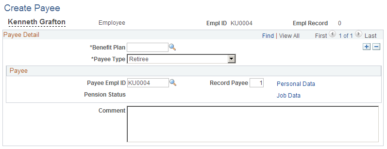

Use the Create Payee page (PA_RT_EMP_SETUP) to Create payee records.
Navigation:
This example illustrates the fields and controls on the Create Payee page.
Note: If there are already payee rows on the page—for example, for an employee's own payee records—insert a new payee row.
Payee Detail
Field or Control  |
Description  |
Benefit Plan  |
 Enter the pension plan that is the source of the pension benefit. If a payee will receive pension benefits from more than one plan, you have to create separate payee records for each plan. You can set up additional retiree and QDRO alternate payee records by simply inserting additional rows under the same payee ID and record number (Rcd# Payee). If a beneficiary requires multiple payee records, you have to access the page using different record numbers in order to correctly associate each beneficiary record with the corresponding retiree record.  |
Payee Type  |
 Select one of the following values:
Dependent/Beneficiary ID  |
 If the payee type is Beneficiary or QDRO Alternate Payee, the payee record is based on an existing dependent/beneficiary record, rather than an existing employee record. In this case, the Dependent/Beneficiary ID field appears. You use it to identify the existing dependent/beneficiary record for a non-employee. You can prompt to see a list of the existing dependents and beneficiaries. Note: You can establish a payee record only for the beneficiaries or QDRO alternate payees who already exist as dependents or beneficiaries of the original employee. If you need to add a beneficiary or QDRO alternate payee, access the Perform Election Entry (BAS_ELECTION_ENTRY) - Dependents/Beneficiaries, using the employee ID of the original employee. You can give a QDRO alternate payee the dependent or beneficiary type QDRO Rec (QDRO recipient).  |
Payee Empl ID  |
 This is the payee's employee ID. Retirees and terminated deferred-vested employees use the same IDs that they used as employees. For this reason, the value that appears in the EmplID field also appears by default in the Payee ID field. Note: Do not change this value for retirees or terminated vested employees. If you do, you will not be able to complete the Create Payee process. An individual who has multiple roles—for example, an employee and a beneficiary of another employee—needs a separate payee record number for each role. Use a naming standard for Employee ID's that is suitable for your needs. Devise a naming standard for beneficiaries and QDRO alternate payees. Adding a suffix to the originating employee's ID clusters beneficiaries and QDRO alternate payees with the originating employee. Using prefixes, one for beneficiaries and one for QDRO alternate payees, clusters everyone with the same payee type. When you set up a Beneficiary or a QDRO Alternate Payee, use an existing Employee ID if this Beneficiary or QDRO Alternate Payee already has an Employee ID. Enter a new Payee ID if this person does not have an Employee ID.  |
Record Payee  |
 Enter the record number for the payee record that you are creating. If a person retires under multiple plans and thus requires multiple record numbers, you can continue to number them sequentially. You might set up a standard that associates certain record numbers with certain plans. For example, you might always use record number 1 for Plan A payees and record number 2 for Plan B payees. For a Beneficiary or a QDRO Alternate Payee who already has an existing Employee ID and employee record number, enter a new employee record number. If a Beneficiary or a QDRO Alternate Payee does not already have an existing Employee ID and employee record number, you can use any record number that is suitable for your needs.  |
Personal Data and Job Data  |
 Click the Personal Data or Job Data link to view a payee's pension status on the personal and job data records. When you complete the information on the Personal Data and Job Data pages and save the records, the system returns you to the Create Payee page. The links are replaced by messages indicating that the data is complete. Note: The system automatically sets the Person Type field, displayed in the Payee Personal Data component, to Pension Payee. For non-employees, data from the dependent/beneficiary record is automatically transferred to the personal data record.  |
When you click the Personal Data and Job Data links on the Create Payee page, you access pages that are nearly identical to those found in the Personal Data (PERSONAL_DATA) and Job Data (JOB_DATA) components of Human Resources. This section discusses only the fields that affect Pension Administration.
