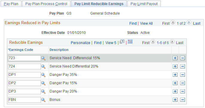

Pay Limit Reducible Earnings Page
GVT_EARN_RE_USF
(USF) Define earnings that can be reduced when pay limits/caps are reached. If earnings are not defined here, earnings over the limits will not be reduced.

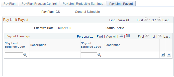

Pay Limit Payout Page
GVT_EARN_PO_USF
(USF) Assign a Payout Earnings Code to each Pay Limit Earnings Code within a pay plan to facilitate the payout of earnings during the first pay period of a calendar year, and for termination payouts.

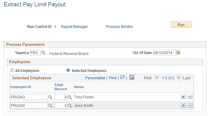

Extract Pay Limit Payout Page
GVT_LIMIT_PAYOUT
(USF) Extract a terminated employee’s lifetime balances prior to loading payout earnings to paysheets.

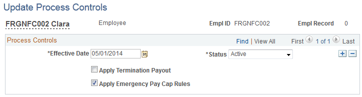

(USF) Use the Update Process Controls page (GVT_EE_PY_PROC) to apply termination payout rules or emergency pay cap rules to override the Premium Pay (bi-weekly) pay cap limit at the employee level.
Navigation:
Payroll for North America > Employee pay Data USF > Update Process Controls
This example illustrates the fields and controls on the Update Process Controls page.
Update Process Controls Page
Field or Control
Description
Apply Termination Payout
Select to apply lifetime lump sum payout for an employee’s termination or transfer.
If the Apply Termination Payout check box is selected here, and the status is Active as of the pay end date on the Extract Pay Limit Payout run control page, then the system extracts the employee’s deferred earnings lifetime balances, and Load Paysheet Transactions inserts them into the Paysheet Transactions record.
Note: You must run the pay limit payout extract process before running the load paysheets process to include lifetime balances in terminated employee’s payout.
If the Apply Termination Payout check box is selected here, and the status is Active as of the pay end date on the Update Payroll Controls run control page, then the Pay Calculation process bypasses pay cap/limit checking when calculating the employee’s paycheck.
Apply Emergency Pay Cap Rules
Select to apply the employee’s annual pay cap instead of the employee’s Premium Pay (bi-weekly) pay limit-premium pay for an employee performing work associated with an organization’s emergency situation.
See the table below to determine conditions for bypassing Premium Pay (bi-weekly) limits for emergency situation pay.
This table shows conditions under which the system bypasses Premium Pay (bi-weekly) pay caps for emergency situation pay.
Emergency Check Box
(Pay Plan Process Control Page*)
Apply Emergency Pay Cap Rules Check Box
(Update Process Controls Page)
Status
Emergency Cap Rules Applied During Pay Calculation?
Selected
Update Process Controls page does not exist for the employee.
NA
Y (apply annual cap)
Selected
Selected
Active
Selected
Selected
Inactive
Selected
Deselected
Active
N (apply bi-weekly cap)
Deselected
NA
Deselected
Selected
Active
Deselected
Selected
Inactive
Deselected
Deselected
NA
*See Pay Plan Process Control Page
(USF) Use the Pay Limit Reducible Earnings (GVT_EARN_RE_USF) page to specify earnings codes of all earnings that are eligible for reduction if employee’s earning exceed pay cap/limit amounts.
Navigation:
Set Up HCM > Product Related > Payroll for North America > Compensation and Earnings > Pay Plan Table USF > Pay Limit Reducible Earnings
This example illustrates the fields and controls on the Pay Limit Reducible Earnings page.
All earnings that should be reduced must be defined on the Pay Limit Reducible Earnings page. If not defined here, the earnings will be paid even if they are over the limits.
Note: Do not define regular pay on the Pay Limit Reducible Earnings page. Regular pay is not reducible per the regulations.
(USF) Use the Extract Pay Limit Payout Page (GVT_LIMIT_PAYOUT) page to extract a terminated employee’s lifetime balances prior to loading payout earnings to paysheets.
Navigation:
Payroll for North America > Periodic Payroll Events USF > Manage Pay Limits > Extract Pay Limit Payout
To load an employee’s lifetime balances to the Paysheet Transactions record, the employee must have at least one lifetime balance and the lifetime balance must be greater than zero. Also, in addition to the settings that you select here on the Extract Pay Limit Payout run control page, the following conditions must be met on the Update Process Controls Page .
  • The Apply Termination Payout check box must be selected as of the As Of Date that you select on the Extract Pay Limit Payout run control page.
  • The payroll controls status must be Active as of the As of Date that you select on the Extract Pay Limit Payout run control page.
This example illustrates the fields and controls on the Extract Pay Limit Payout page.
Field or Control
Description
Agency
Select the agency to process.
As Of Date
Enter the date to use for processing.
Note: Do not run the extract more than once for an As Of Date. Running the extract for a second time for the same As Of Date will result in the creation of additional transactions, which if loaded to the paysheet, can result in duplicate payments to the employee.
All Employees or Selected Employees
Identify the employees to process. You can choose to process all employees in the agency as of the date specified, or select the Selected Employees option to identify only specific employees to process.
Note: If the specific employees that you select are not in the specified agency on the As Of Date, they will not be processed.
(USF) Use the Pay Limit Payout Page (GVT_EARN_PO_USF) page to assign a Payout Earnings Codes to each Pay Limit Earnings Code within a pay plan to facilitate the payout of earnings during the first pay period of a calendar year, and for termination payouts.
Navigation:
Set Up HCM > Product Related > Payroll for North America > Compensation and Earnings > Pay Plan Table USF > Pay Limit Payout
This example illustrates the fields and controls on the Pay Limit Payout page.
Field or Control
Description
Enter the earnings code of the pay limit to use.
Assign a Payout Earnings Code for each Pay Limit Earnings Code within a pay plan to facilitate the payout of earnings during the first pay period of a calendar year and for termination payouts.
Specify the Payout Earnings Code from which to pay the pay limit earnings, subject to the specified pay limit.
Note: A unique Payout Earnings Code is required for each Pay Limit Earnings Code within a Pay Plan. If a Payout Earnings Code is not unique, an error message appears. Also, the Payout Earnings Code cannot be the same as the Payout Limit Earnings Code. If the two earnings codes are the same, an error message appears.
The Create Paysheets process loads paysheets with lifetime balances for the first pay period of a calendar year, and for terminated employees. (For terminated employees, the lifetime balances must first be extracted.) If the process finds a Payout Earnings Code on the Pay Limit Payout page, it loads payout earnings into the Other Earnings section of a paysheet. Manual updates by the users to the payout earnings on an employee’s paysheet could result in the payout amount being greater than the employee’s lifetime balances. Use caution in updating the paysheets manually.
