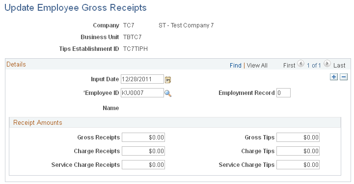

(USA) Use the Update Employee Gross Receipts page (TIPS_EMPL_INPUT) to specify the gross receipts to which an employee's tips apply in each tip establishment.
Navigation:
This example illustrates the fields and controls on the Update Employee Gross Receipts page.
Field or Control |
Description |
Input Date |
Enter the input date, which should be between the start date and the end date (posted date) of the period for which you're calculating or approving the tip allocations. |
Employment Record (employment record number) |
Enter an employment record number for employees with multiple jobs. |
Receipts Amounts
Field or Control |
Description |
Gross Receipts |
Enter the gross receipts to which the employee's tips apply. |
Service Charge Receipts and Charge Tips |
Enter the service charge receipts and service charge tips that apply to employee tips. The system uses these values to calculate the amount to report for each Establishment Serial Number on Form 8027 under Service Charge Less than 10%. |

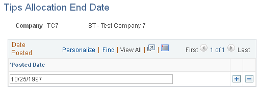

Use the Tips Allocation End Date page (TIPS_ALLOC_PD) to select the end date for the tip allocation. Use the same pay end date as your allocation end date.
Navigation:
This example illustrates the fields and controls on the Tips Allocation End Date page.
Field or Control |
Description |
Posted Date |
This date must match the date that is entered on the run controls for calculating allocated tips and for updating the balances. |

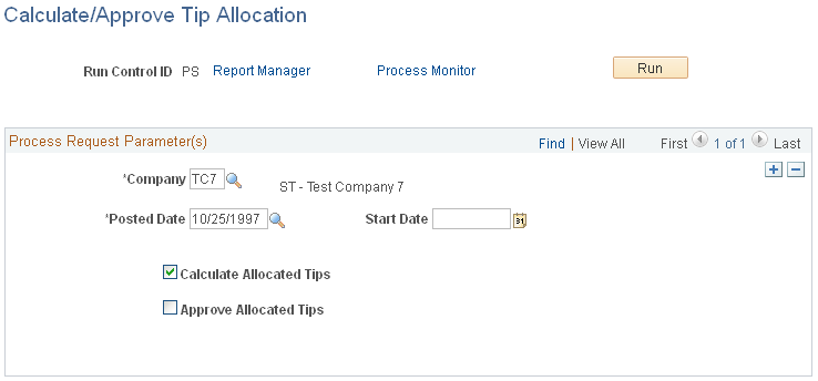

(USA) Use the Calculate/Approve Tip Allocation page (RUNCTL_TIPS_ALLOC) to run the Run Tip Allocation COBOL SQL process (PSPTARUN), and (after you are satisfied with the results) approve the allocated tips.
Navigation:
This example illustrates the fields and controls on the Calculate/Approve Tip Allocation page.
Field or Control |
Description |
Posted Date |
Select the end date of the period for which you're calculating or approving the tip allocations. |
Start Date |
Select the start date of the period for which you're calculating or approving the tip allocations. |
Calculate Allocated Tips |
Select to run or rerun the calculation process. You can run the calculation process as many times as you like until you run the approve process. After you run the approve process, you cannot run the calculation process again for that company and allocation date. |
Approve Allocated Tips |
After you check the results of the calculation process, and you are satisfied with the calculation, select this check box to run the approve process. |

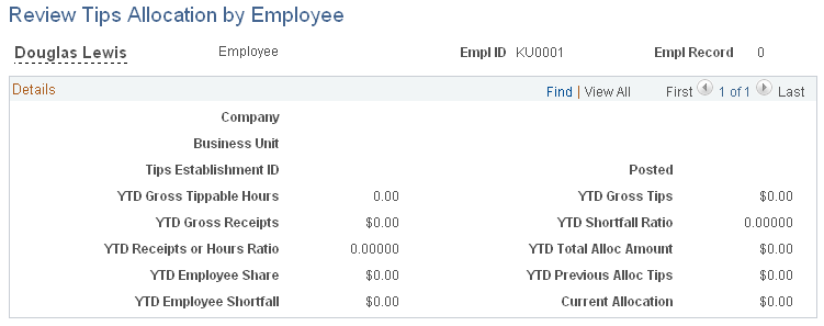

(USA) Use the Review Tips Allocation by Employee page (TIPS_EMPL_PD) to view the record of an individual employee's allocations.
Navigation:
This example illustrates the fields and controls on the Review Tips Allocation by Employee page.
Note: You can view all the allocations of an individual employee even if that employee has allocations for more than one establishment. This page is display-only.

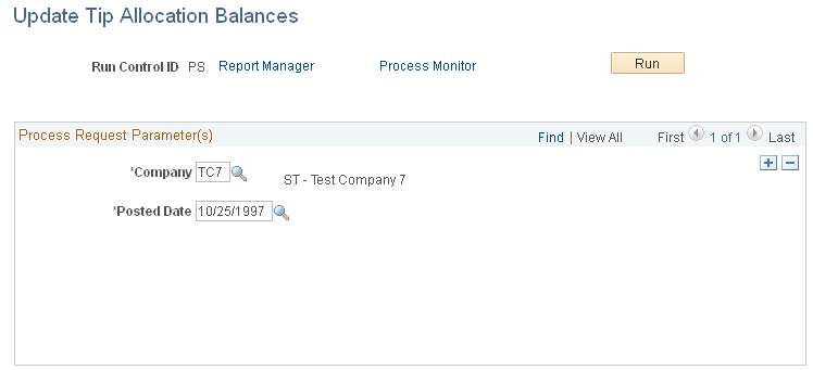

(USA) Use the Update Tip Allocation Balances page (RUNCTL_TIPS_ALLOC) to run the Update Allocation Balances SQR Report process (PAY053) and produce the Update Allocations Balances audit report.
Navigation:
This example illustrates the fields and controls on the Update Tip Allocation Balances page.
The report lists, by employee, the current allocation amount, the year-to-date (YTD) allocation amount after the current update, the YTD hours (if tip allocation method is hours), and the allocated tips earnings code that is updated. Before using this page, you must approve the allocated tips calculation.
Field or Control |
Description |
Company |
Enter the company which you are updating tip allocation balances. |
Posted Date |
Select the end date of the period for which you're updating tip allocation balances. The value comes from the Tip Allocation End Date page. |

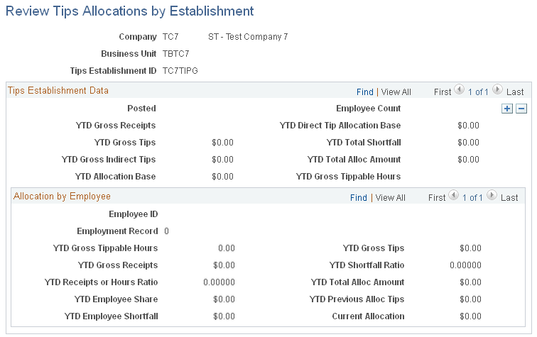

(USA) Use the Review Tips Allocations by Establishment page (TIPS_ESTAB_PD) to generate the PAY050 report, which lists tip allocation information for establishments.
Navigation:
This example illustrates the fields and controls on the Review Tips Allocations by Establishment page.
Note: Access the Review Tips Allocation by Employee page to view allocations for an individual employee.

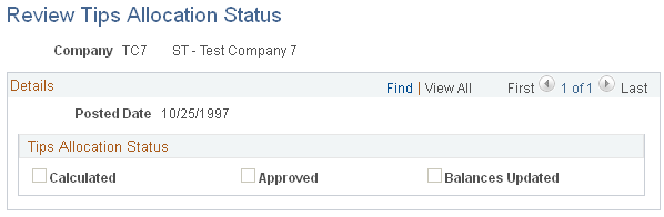

(USA) Use the Review Tips Allocation Status page (TIPS_ALLOC_ST) to review the status of the tip allocation process for a company.
Navigation:
This example illustrates the fields and controls on the Review Tips Allocation Status page.
This group box indicates the company's tip allocation status as of the allocation end date.
Note: At the end of the process, all boxes should be selected as complete for that cycle.

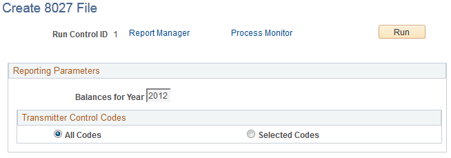

(USA) Use the Create 8027 File page (RUNCTL_TAX960TP) to generate the file for electronic submission of IRS Form 8027, Employer’s Annual Information Return of Tip Income and Allocated Tips.
Navigation:
This example illustrates the fields and controls on the Create 8027 File page.
