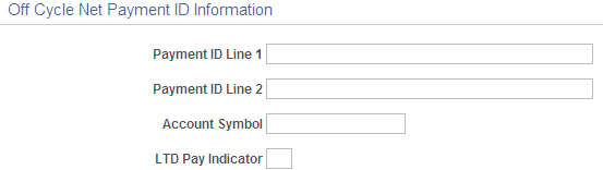

(USF) Use the Off Cycle Deduction Payment ID Information page (GVT_ECS_DED_SEC) to view off-cycle deduction payment ID information for each eligible payment.
Navigation:
Select the Line ID Data button on the Off Cycle Deduction page.
This example illustrates the fields and controls on the Off Cycle Net Payment ID Information page.
Important! PeopleSoft ECS interface process has been replaced by the Treasury Interface functionality.
The fields on this page are the same as the Off Cycle Net page, with the following exceptions.
